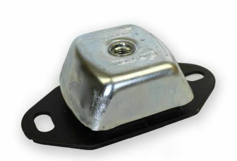

  7. Here is a photo of this type of mount. The stud is a totally separate part which may or may not be used dependent on application. If used with the stud then this is just screwed in and locked into position with the thin locknut. The only thing to watch out for is the stud itself. There have been various versions of this mount. Some use a shouldered stud which is fine, just screw in until the shoulder buts up to the top of the mount and tighten locknut. Also you come across this same style of mount that uses a parallel stud. With this type you need to be a little more careful because you determine the stud position and then lock in place. I have come across a number of cases where the stud had been screwed in to far before locking in position. This results in the lower end of the stud tapping/knocking on the engine bearers while engine is running.
