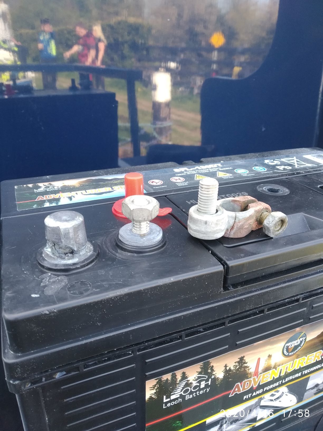

Hi All Well, thanks for all the advice - I put some vaseline on all the terminals and glued a protective plastic cap over the entire terminal. I put the whole lot back together and using the Aux. post it seems to be okay. I haven't used the bow thruster in anger yet, so I'll be sure to let you know if it fails or blows a fuse - at some imperative point in the future. Thank you again Alistair
Hi All I want to get advice on the aux. terminal of my battery - it is one of two fitted for my bow thruster. The story so far - I have been the owner from new of my barge - around 6 months - fitting out. Recently I decided to open the battery box housing the bow thruster batteries. Not opened before, so due for an inspection and clean. I noticed some build up of the dreaded green "moss" around the positive terminal and removed the battery for a proper clean...that's when I noticed the cracked terminal clamp...then the eroded terminal... I think the cracked clamp was arcing and eroded the terminal...the terminal is now leaking, causing the green moss to "escape"... My idea to resolve this is to move the cables over to the available aux. post - the thread size is the same for nuts. Repair the leaking terminal with either silicone or epoxy and leave be. Question: Can the Aux. post take the current draw? Probably around 600A? If yes, then, is there a better sealant for the damaged battery post? Cheers Alistair
