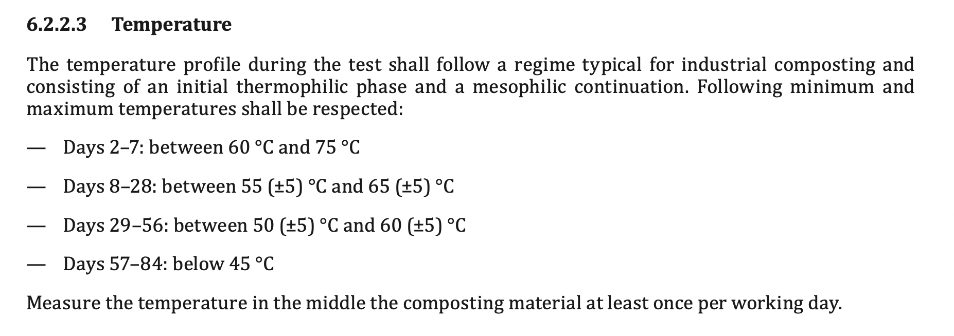

  15. Above is an extract from the ISO 16929 test method (EU standard) for the temperatures that have to be used when doing the fragmentation test for industrial composting. The temperatures are deemed by the standards body to represent what happens in an industrial Windrow compost heap (but that's another story). In our lab test we have units similar to the mini hot bins operating for the 12 weeks of the test at this temperature. Everything that is used by industrial composters is fully composted after 12 weeks at these temperatures - note most of them avoid anything man made like cups, plates, wet wipes even if they are stamped compostable. These temps CANNOT be sustained in a small uninsulated box. You can achieve them easily in an insulated 50-100L box but only if you feed them regularly ie twice a week. This is the basis of the mini-hot bin. Go to their web site and see how they work. They do work on boats but you need to feed them kitchen waste as you wont have enough poo to feed them so you then end up with loads of great compost - but what then do you do with it. Our 120L a year is fine for our pots but I guess with a hot bin you'd make over 300L a year. Keeping the temp up at these levels is easy with a hot bin. For us mere mortals trying to compost smaller quantities ie 20-40L in an uninsulated box, you will never achieve any real temperature rise, so using the boat roof as a radiator between April and October is the answer to get the material up to 50-60°C to assist in killing the pathogens (along with time) - see the humanmanure book. Hence the 6-9 months compost time depending on season. You also do need to get the water content right and turn it regularly - once a month - when its on the roof.
