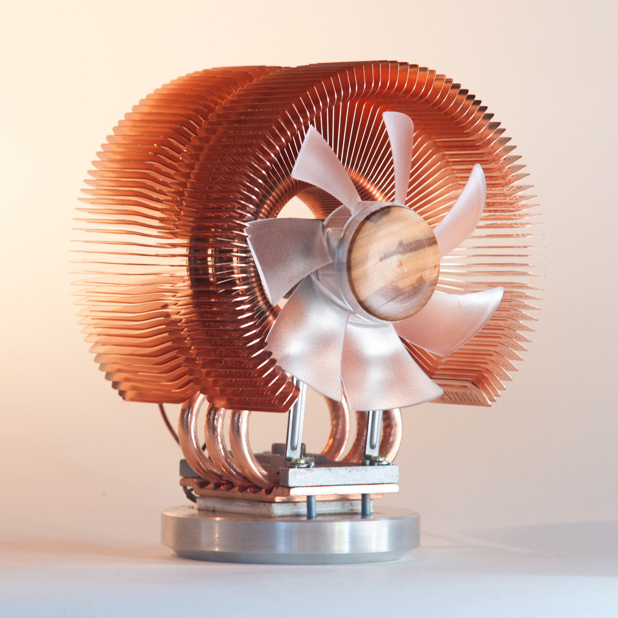

  3. for fan envy I vote for one of these
