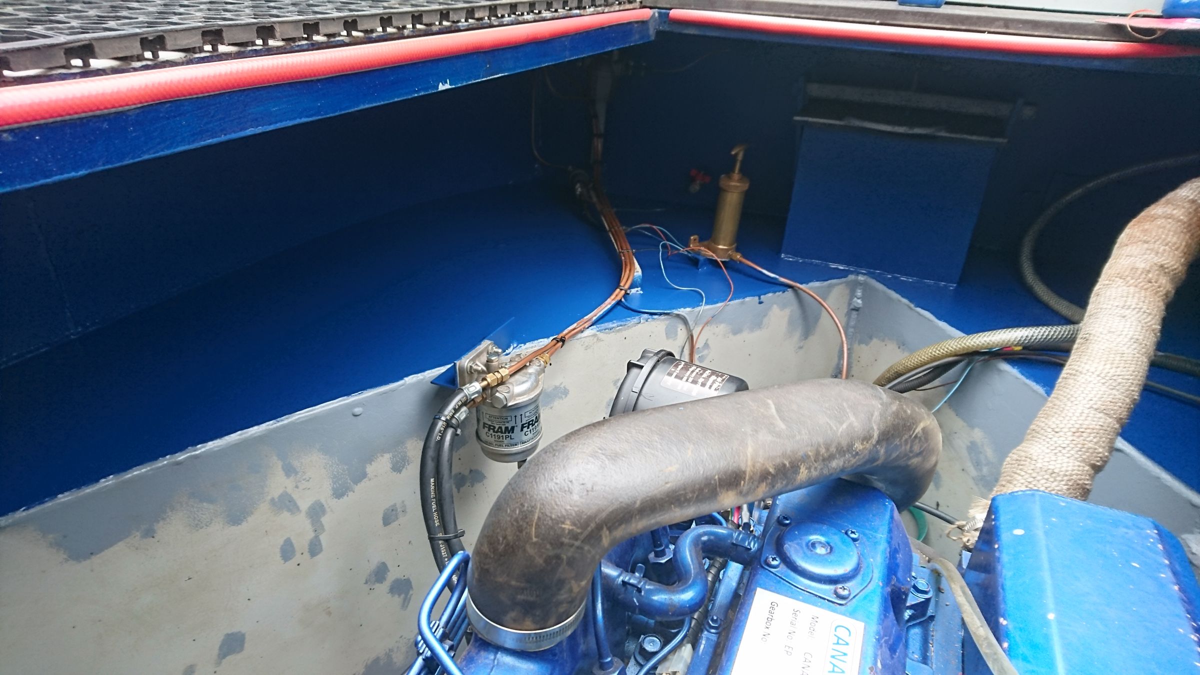

Thanks I should have taken a before pic - just imagine a lot of heavy surface rust on the counters and a few inches of oily water and muck in the (now bone dry) bilge! Will finish the latter in light grey for contrast.
And I got a couple coats of zinc primer on over the last few days and today the second top coat... next time will do the lower bits but this was enough for now as I repainted everything - very uncomfortable in there!

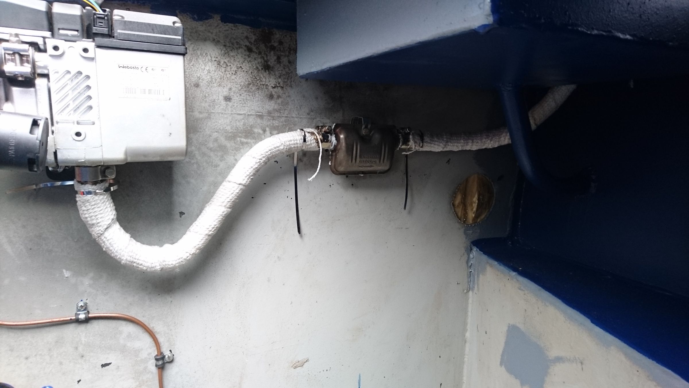

Just thought a fitting addition to this thread, I finally got around to lagging my Webasto exhaust pipes. While I was at it I took the silencer off to turn it around (so the drain hole which I now know about is pointing down not up* - yet strangely this means the logos are upside down?). Plus I wanted to see if there was any condensation in there. All bone dry and it was hard to remove the exhausts with the silencer sealant I had used. To my surprise, some of the sealant on each side of the exhaust had expanded so much that the hoses were almost blocked - yet of cours it's been running ok. As a precaution I took the end off at the heater, which also had a big clod in it. The skin fitting looked clear so left that. All back together nice and neat now. * I blocked the hole up for fear of fumes creeping in, and because the whole system was totally bone dry anyway - but I can easily poke it through if I ever want to check then seal again if necessary.

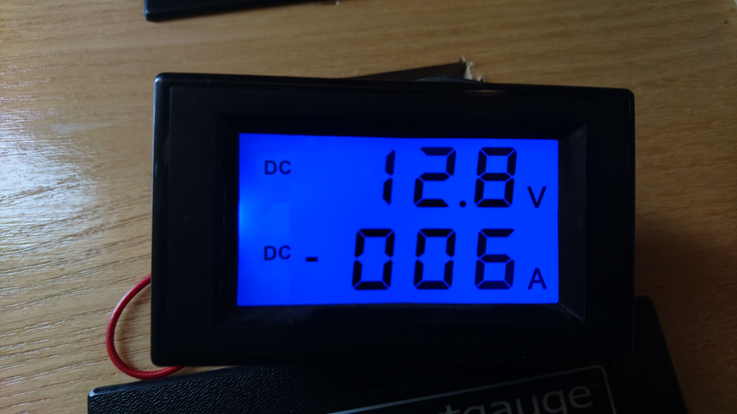

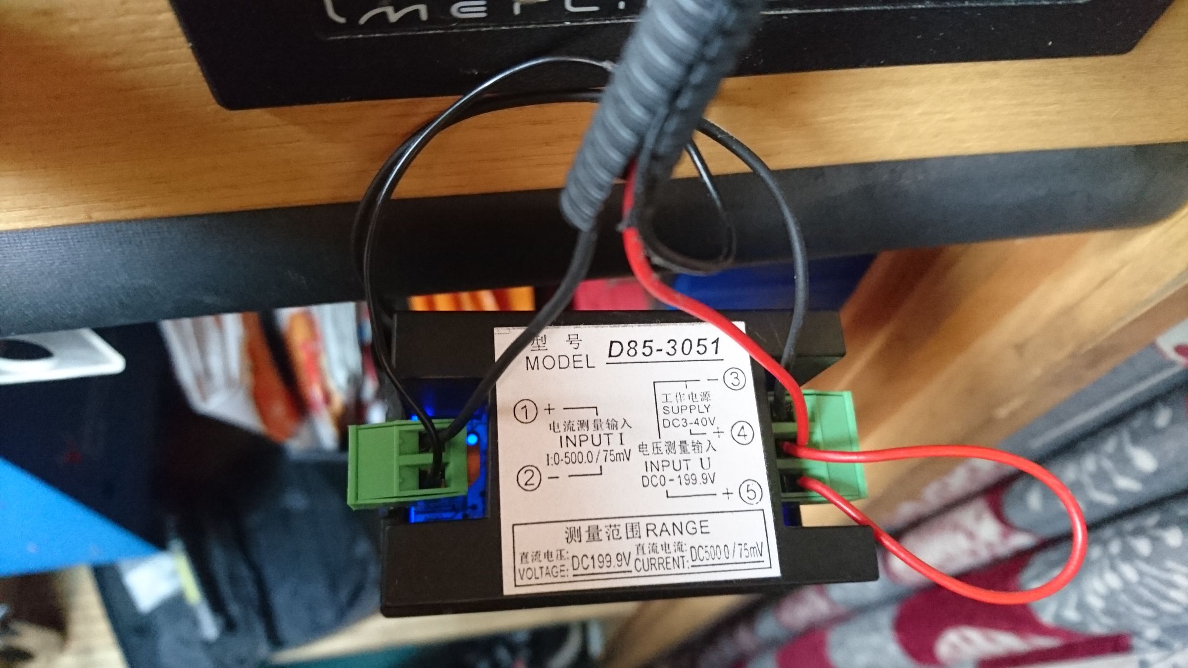

It does, but I have actually got the sense wires going into the sense and the supplies for the supply, I think. It's this meter... https://www.ebay.co.uk/itm/DC-0-200V-0-500A-Volt-Amp-Meter-Battery-Monitor-Charge-Discharge-12V-24V-36V-DS/171213089055?ssPageName=STRK%3AMEBIDX%3AIT&_trksid=p2057872.m2749.l2649 The thing is this one has a dot in the display - maybe mine should have and it doesn't work. Also mine has one terminal less...
I thought you'd cracked it for a minute there Wotever. I disconnected the -ve supply and the meter just still works as usual. Then I connected the -ve to a ground elsewhere (one of my 12v sockets) and low and behold... I get -49 amps! There are two +ves, but it did say that the meter can be powered from what it is monitoring "no need different supply." Of course I have mucked around with the trim pot but that just makes things even worse. The thing about the meter reading - to be clear, the last post (the meter reads 0.1) is the dvm I was using to check the voltage drop across the shunt, the op was when I was talking about "the meter" as being the installed ammeter!
That's a really good point, 4 to 5 meters I'd say, and they are not very thick either. The way I wired it, the sense wires from the shunt go to the sense wire connections on the meter. The positive comes from its own dedicated fused wire from the batteries. This links to another pin that requires 12v on the meter. The ground supply for the meter I took a loop off the sense wire that is on the battery side, rather than running one separately.
The mV thing was a good idea - I measured across the sense wires when they were unplugged and got 0 or 1mv, then plugged them into the meter and got 0.6mv. In both cases with minimal load (radio and laptop on) so it shows the meter is affecting its own readings. Also some confusion regarding how it is wired as the online instructions in the advert show a different thing to what I have got. I had the -ve supply wire tied to the wrong side of the shunt (the not battery side) but surprisingly didn't seen to make any difference. Then took the thing apart and found a multi turn pot - with the sense wires unplugged/shorted it doesn't affect the reading (always at 000) but with sense wires in I set it so it was just off 000/001 then tried some loads, which didn't show up. And it doesn't see to see the power going in from the solar Waste of time. Thanks all. As far as the mV / shunt thing - surely any meter would just be calibrated to whatever shunt it specified? So all things being equal (ie 75mv shunt) a 100a meter would show 100a when there is volt drop x across the shunt, a 500a meter would show the same 100a for the same x, and 5x for 500a? The thing being to make sure the shunt is meaty enough for the application (and the meter software allows it to display the relevant figures).
That's what I thought - something warm somewhere. But now I just think it is the meter miss reading - or the shunt or problem with how it is wired. Easiest option is to try a different meter (they all seem to use 75mv shunts?). This one only goes down to 1a so not much use for seeing what the small items use anyway. That's what I thought - something warm somewhere. But now I just think it is the meter miss reading - or the shunt or problem with how it is wired. Easiest option is to try a different meter (they all seem to use 75mv shunts?). This one only goes down to 1a so not much use for seeing what the small items use anyway.
