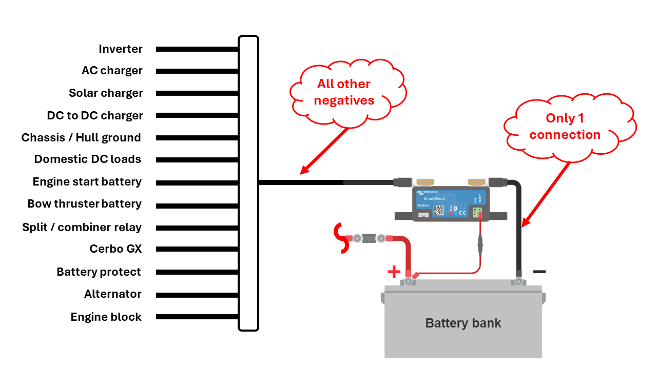

  1. Perhaps you should read the diagram again to spot the connections that state "Engine start battery" and "Chassis / hull ground" and " Engine block".
  2. Here is a simple sketch from the Victron community for wiring a battery monitor shunt, you may not have every device shown.
