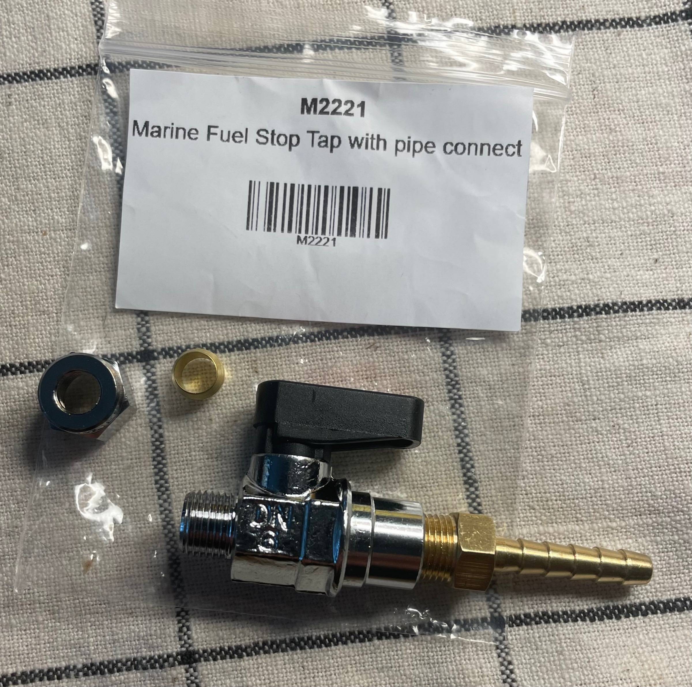

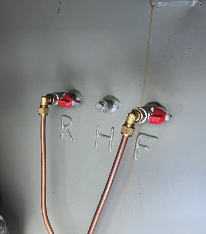

Adam1991 Posted October 31, 2024 Report Posted October 31, 2024 Hi I’ve bought this m2221 fuel tank valve from mellor online which is for connecting to a stand pipe. I have an unused fuel tank available to connect to. Is there an adaptor or part that would allow me to directly connect to this fuel tank thread with the valve I’ve got here? See both images below. Sorry to repost more question about the same fuel tank connection 😂 Just struggling to work out how to run the heater pipe and connect it up as this valve is around half the size of the receiving thread on the tank. (The red valves already there a beefier than the one I’ve ordered) thanks for any advice !
Tony Brooks Posted October 31, 2024 Report Posted October 31, 2024 (edited) You buy an adaptor or adaptors from a plumber's supplier, probably in black iron, but could be brass. You will however need to know the thread size and type that is in the boss on the tank. It looks to me as if you may have bought an over sized tap for that thread. I am by no means certain, but I think the boss will be 1/4 BSP parallel. You could take the plug out as long as the fuel level is below it, and take it to a plumber's merchant to get a tap that screws into the boss you took it out of. They should have ones with fuel resistant seals for oil fired central heating systems. That way, you won't end up with an array of adaptors so you keep the tap close to the tank for a degree of protection.. Edited October 31, 2024 by Tony Brooks
Adam1991 Posted October 31, 2024 Author Report Posted October 31, 2024 Great idea Tony, I’ll take the plug with me & the tap to a plumbers merchants. Probably the simplest way to work the problem out. thanks for your help!

David Mack Posted October 31, 2024 Report Posted October 31, 2024 7 hours ago, Adam1991 said: Hi I’ve bought this m2221 fuel tank valve from mellor online which is for connecting to a stand pipe. I have an unused fuel tank available to connect to. Is there an adaptor or part that would allow me to directly connect to this fuel tank thread with the valve I’ve got here? See both images below. Sorry to repost more question about the same fuel tank connection 😂 Just struggling to work out how to run the heater pipe and connect it up as this valve is around half the size of the receiving thread on the tank. (The red valves already there a beefier than the one I’ve ordered) thanks for any advice ! Your tap looks to have a compression fitting for copper pipe on the left hand end and a female thread with a brass hose adapter screwed in on the right hand end. Doesn't look like the best valve for the purpose, but it can probably be made to fit. There should be an arrow marked on the body showing the direction of fuel flow. Can't see it in the picture, but it may be on the other side. If you tell us which way the arrow is pointing we can advise how best to connect it up.

Adam1991 Posted October 31, 2024 Author Report Posted October 31, 2024 Thanks Tony, it’s a hot air heater. Hopefully it will be ok pulling air to be warmed from the engine bay otherwise I’ll pull the air from inside as you mentioned. Cheers. 27 minutes ago, David Mack said: Your tap looks to have a compression fitting for copper pipe on the left hand end and a female thread with a brass hose adapter screwed in on the right hand end. Doesn't look like the best valve for the purpose, but it can probably be made to fit. There should be an arrow marked on the body showing the direction of fuel flow. Can't see it in the picture, but it may be on the other side. If you tell us which way the arrow is pointing we can advise how best to connect it up. Hi David, thanks for your response. The barbed end is the direction of flow. The thread on the opposite end is slightly smaller than the thread available on the fuel tank so some sort of adaptor would be great.
