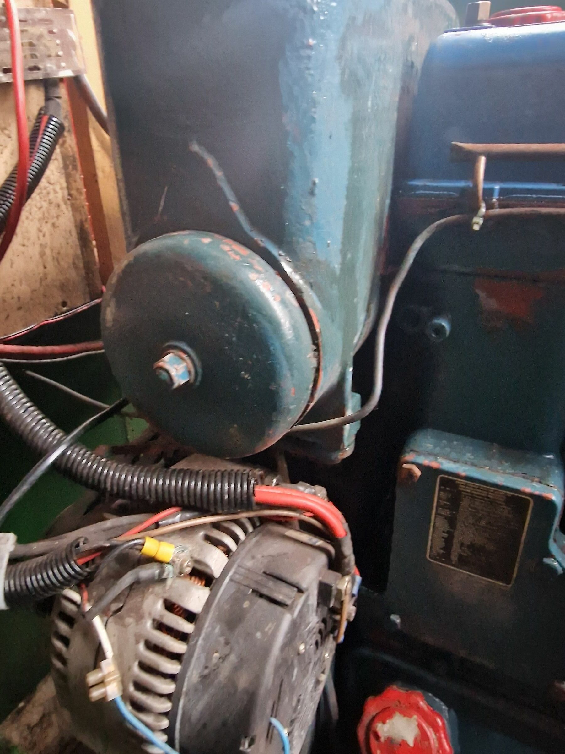

Kris9128 Posted September 10, 2023 Report Share Posted September 10, 2023 Evening all. Does anyone know how to get the end caps off the heat exchanger. I undid and removed the centre nut. Tried twisting the cap off, Tried pulling it, tapping it with rubber hammer, shouting at it, swearing at it even resorted to praying to a diety I don't believe in for some divine intervention but the little sod refused to budge. Any help, advice would be greatly appreciated. Thanks, kris Link to comment Share on other sites More sharing options...

RLWP Posted September 11, 2023 Report Share Posted September 11, 2023 It needs violence to remove it - and be careful. The cap will probably be OK, if you strain the heat exchanger you'll make the tubes leak, and the shell is alloy and probably corroded. Don't be surprised if the flanges come off Why do you want to dismantle it? Richard Link to comment Share on other sites More sharing options...
Kris9128 Posted September 11, 2023 Author Report Share Posted September 11, 2023 1 hour ago, RLWP said: It needs violence to remove it - and be careful. The cap will probably be OK, if you strain the heat exchanger you'll make the tubes leak, and the shell is alloy and probably corroded. Don't be surprised if the flanges come off Why do you want to dismantle it? Richard Over heating issues. The boat i bought was used by an old boy (sadly passed away last year) and hasnt really had much use in the last 8 years. I've stripped and cleaned everthing else, including the skin tank. The amount of crud that came out was quite suprising. The feed pipe into th eheat exchanger was clogged with crud and other stuff. Link to comment Share on other sites More sharing options...
RLWP Posted September 11, 2023 Report Share Posted September 11, 2023 Flush it through a few times in alternating directions to make sure it isn't blocked. Also flush the tank out as much as you can If the boat has a skin tank you don't really need a heat exchanger. I presume the rubber pump rotor is OK? Richard Link to comment Share on other sites More sharing options...
Kris9128 Posted September 11, 2023 Author Report Share Posted September 11, 2023 Thanks for the advice, everyone. Just got back from the boat, what a dirty messy job that was. End caps came off reasonably easy in the end. Used a small knife edge chisel and a small pin hammer. Took my time chasing the gap around. Few squirts of wd40 and they both came off with no issues or damage. That was the easy bit. The exchanger was absolutely gummed up with gunk and jizz. Spent 4 hours with lengths of 2mm wire poking all the tubes out. Washed it through a few times and bolted back together. Washed through a few more times and all clean. Need to order about 3 miles of coolant hose and 300 clips. Then job finished and test run on the weekend. Again, thanks for the help Kris Link to comment Share on other sites More sharing options...
