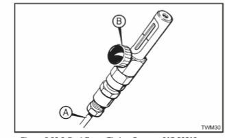

Here is a much better way to carry out your spill timing. By using one of these tools it saves having to take the delivery valve out, of having to rig up a gravity feed to the pump. So much cleaner and easier way to do it. I don't know what the cost of the tool would be.
