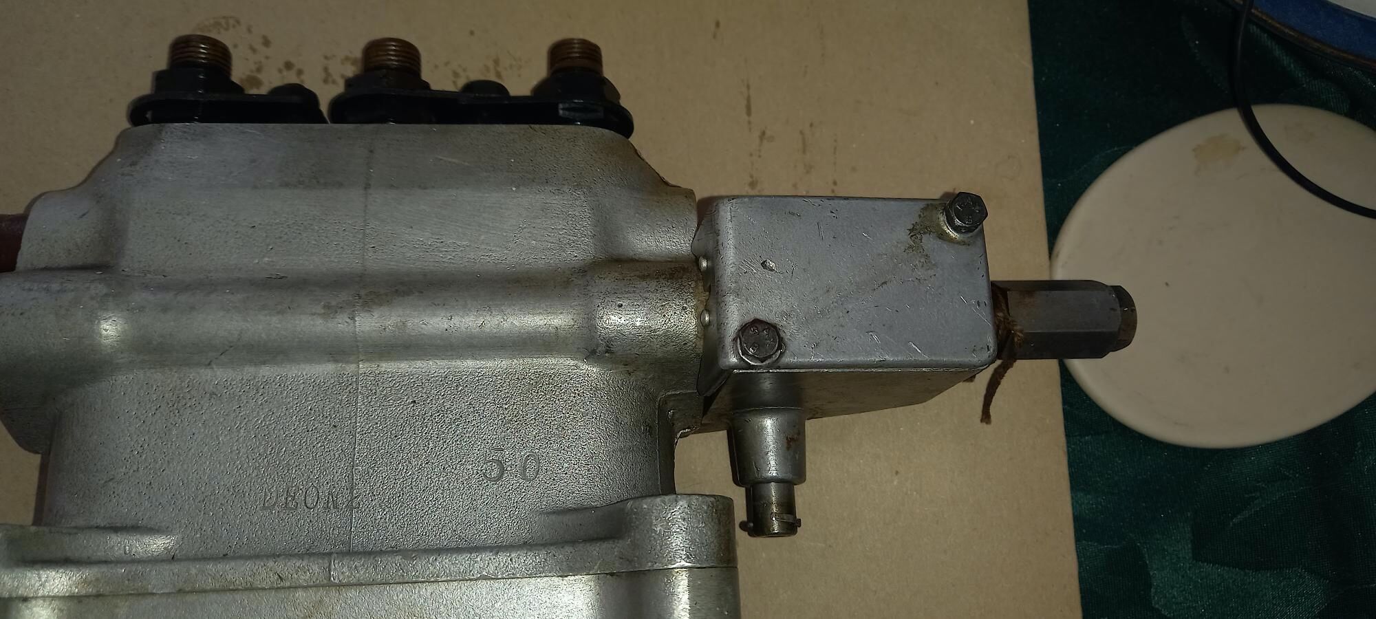

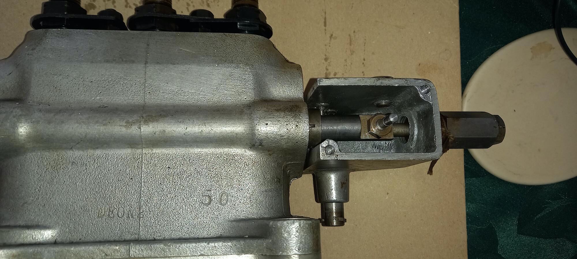

The spring should be simple to change, no risk of it flying anywhere as it is under little tension.
See pictures below. In the second picture remove the two small hex head bolts from the back of the pump and take the cover off. This will reveal the spring  with its end over the small rod. Lift off and replace with new spring.
You may find the spring has been stretched to allow operation at lower than normal tickover speed. After replacing it you may need to adjust the governor.
To oil the rack its the slotted head screw on the face of the injection pump (the side away from the engine). Take it out and squirt engine oil in.

When setting the tickover follow the instructions in the manual very carefully. It is set by the flanged nut on the end of the governor housing, not the screws on the throttle lever. The rack buffer (the hex screw as seen in the pic above from Chris) needs to be carefully set as well particularly when the tickover is set to 320 rpm as per the manual..
The spring that is fitted looks like it was for a 6LW where it has to do much more work, I assume that you have ordered this one https://gardnerspares.com/product/spring-rack-bar-2-point/

The pictures make it look much simpler than the exploded diagram suggests, should be easy enough to do when the spring gets here.
