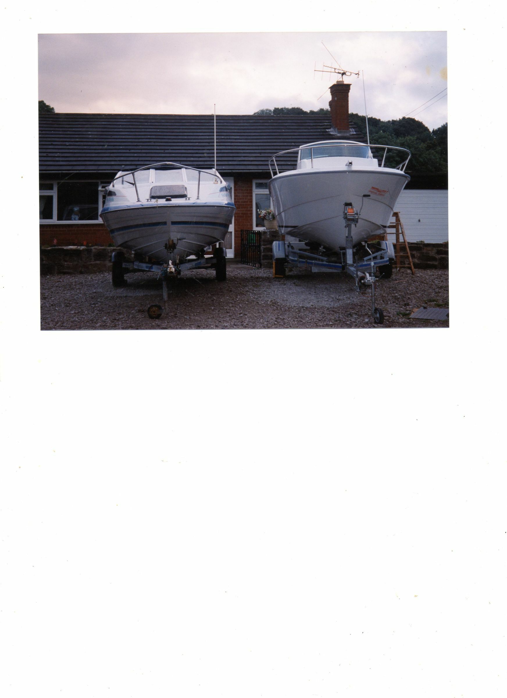

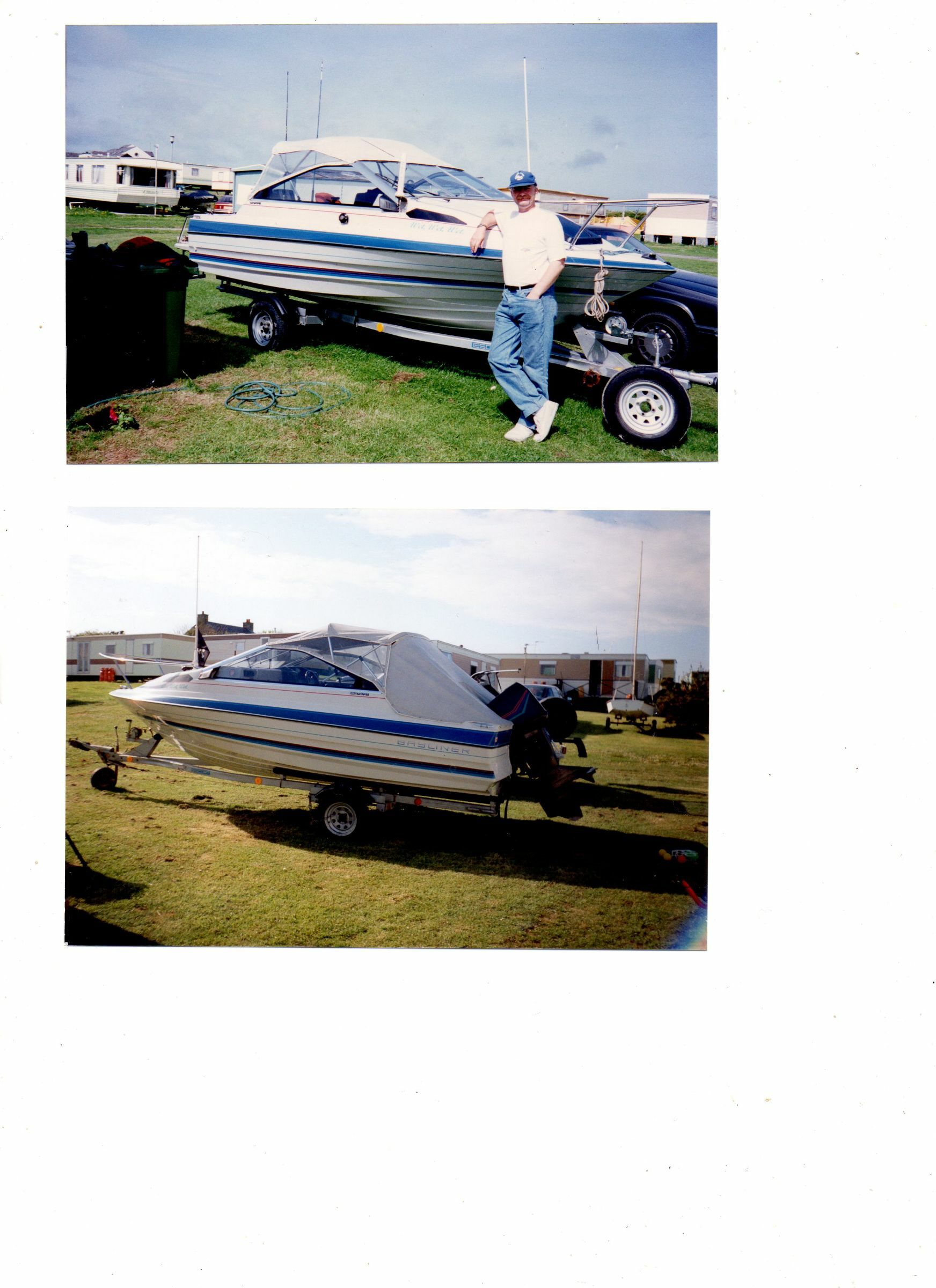

A 'couple' of Sports Cruisers we had - both outboard powered and both totally unsuitable for the canals or rivers.
Bayliner on the left with no 'walk around gunwales' and a Benetau on the right which had a proper walk way all around the cabin (hence the WA in the model name).
And a Dell Quay Trihedral Hullwith twin 50hp outboards
