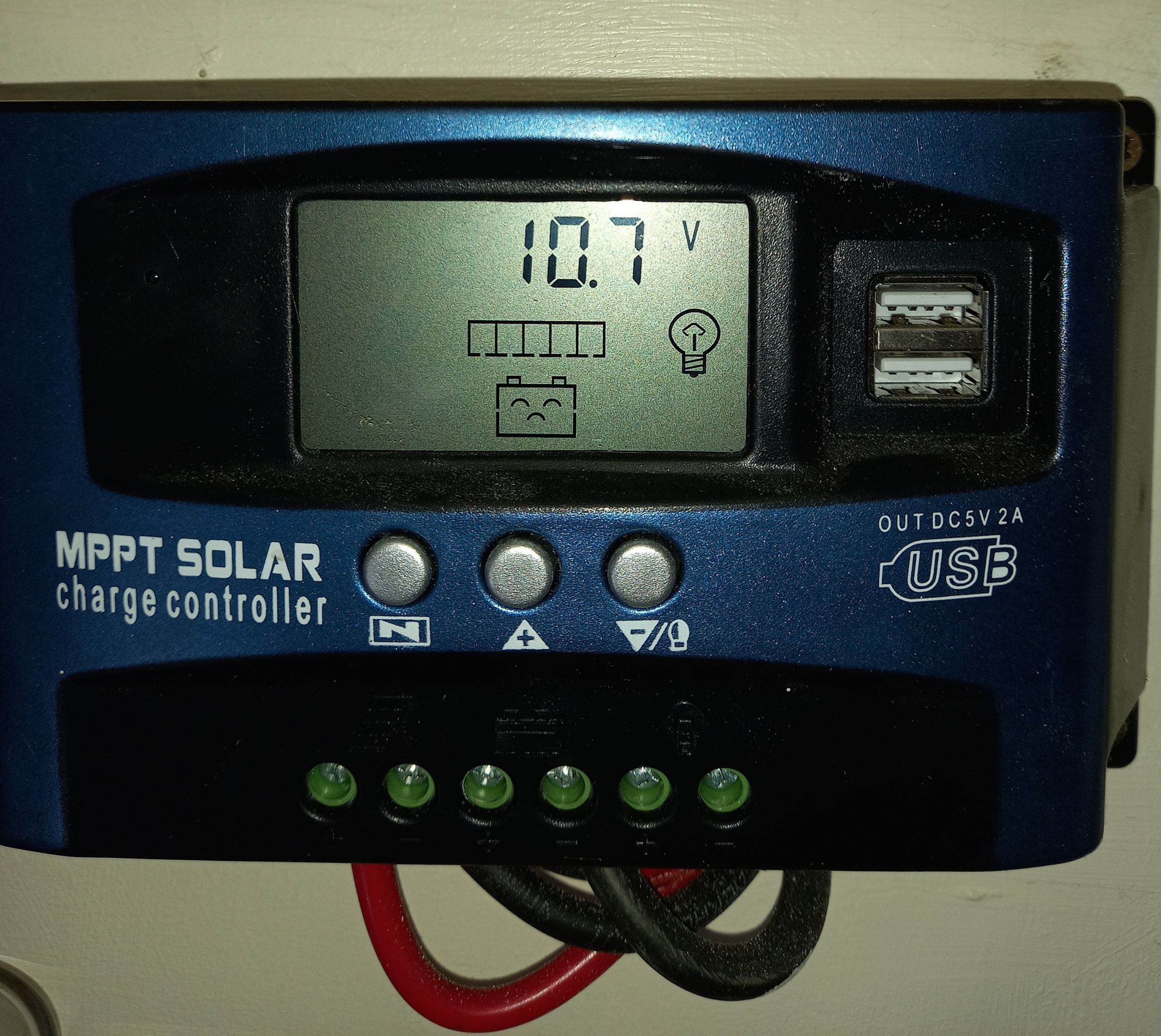

Hello. Just started cruising on my refurbished 45 boat but there is a problem with charging the batteries, I'm sure. It has had a new alternator fitted but I think maybe only the solar panel is doing the charging. For starters can anyone link me the instructions for this solar control panel because I'm finding it difficult to understand what it is telling me. The photo attached doesn't look happy. Many thanks, Chris.
Ps. The chap who fitted it has misplaced the instructions.
If the voltage shown is the battery voltage, then nothing has been charging the batteries and the batteries are now dead.
Do you have a multimeter ?
Test the voltage at the actual batteries and see what it reads.
You only look to have 3 wire going into/out of the controller.
You would normally need 4 wires as you need :
Both + and - from the panels to the controller, and
Both + and - from the controller to the batteries,
If the person needed instruction then I take it he was not a boat electrician, and / or had never installed panels before ?

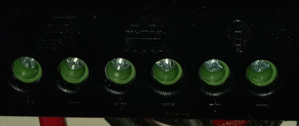

Having looked at the photo in another program:
1. Remember that the battery must always be connected to the controller BEFORE the panels. So disconnect and insulate one of the panel cables until the battery is connected, then connect it again.
Working from left to right on the photo
terminal 1 = panel pos
terminal 2 = panel neg
terminal 3 = battery pos
terminal 4 = battery neg
I would suggest you ignore the next pair for now but typically they will be:
terminal 5 = solar load pos
terminal 6 = solar load neg
The buttons normally allow you to cycle through display options and maybe zero cumulative counts of Ah etc. It should still charge however you set them.
Also, I suspect this is a PWM controller, so in time think about swapping it for a genuine MPPT one that will give more charge for the same panel size.
terminal 1 = battery pos
terminal 2 = battery neg
terminal 3 = panel pos
terminal 4 = panel neg
Looking at the photo, and struggling to make out the pictograms, it looks to me, like it is the central two terminals that are 'battery'
Absolutely correct, now edited. Came from a small laptop screen and having to swap between program screens during writing.
Thanks
In the usual order: It would be - Positive solar, Negative solar, Positive battery, Negative battery, Positive load, Negative load. These are the positions being displayed in the photo. You can make out the solar panel image, battery, and light bulb-type symbol of the load input and output positions.

This is not an MPPT charge controller, although those initials are on the face of the gadget. "MPPT SOLAR" it's only a name given to the unit. Misleading, but that's shopping on the internet for you. You will find a good source of info in youtube videos and reviews.

I would suggest you swap out the charge controller you have, replace with a real MPPT unit. The one you have will drag the panel voltage down to something near the value of the battery, it's a simple regulator. An MPPT will do more work, to charge the batteries.
