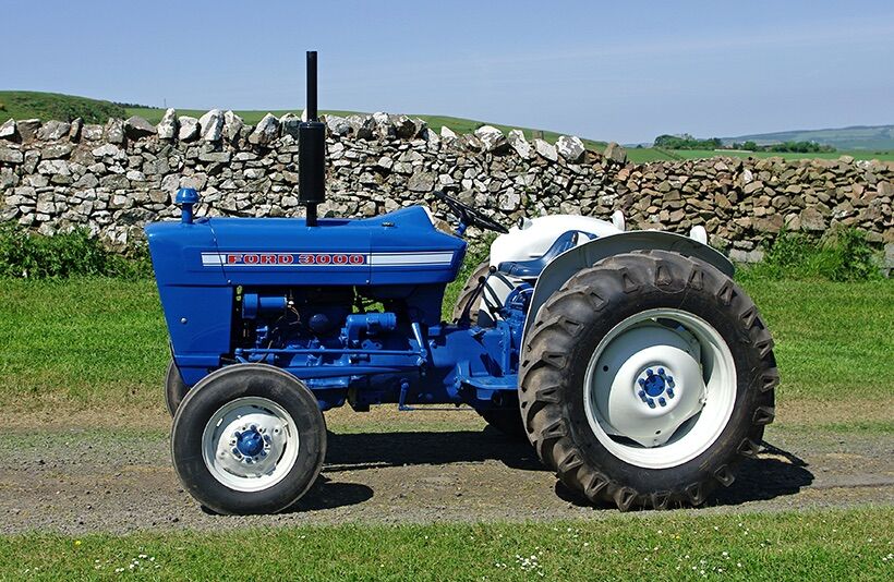

You do know, of course, that the BD3/CRK3 is a Ford 3000 tractor engine .
Yes I did but which Tractor engine is it exactly.
The model was the 3000 , of 3 litres capacity. The earliest model was also called SuperDexta, which had a cartridge type oil filter rather than the later spin on type. I have a list of alternative oil filters , Beta ones are dear. Currently using a longer Bosch P4063.
I think that one is a '65 Preforce 3000.
