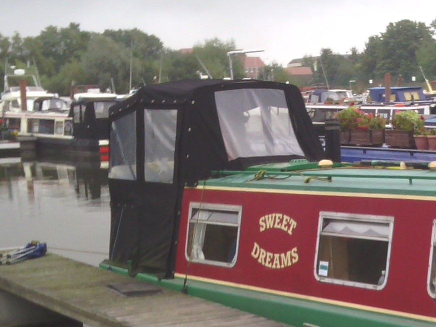

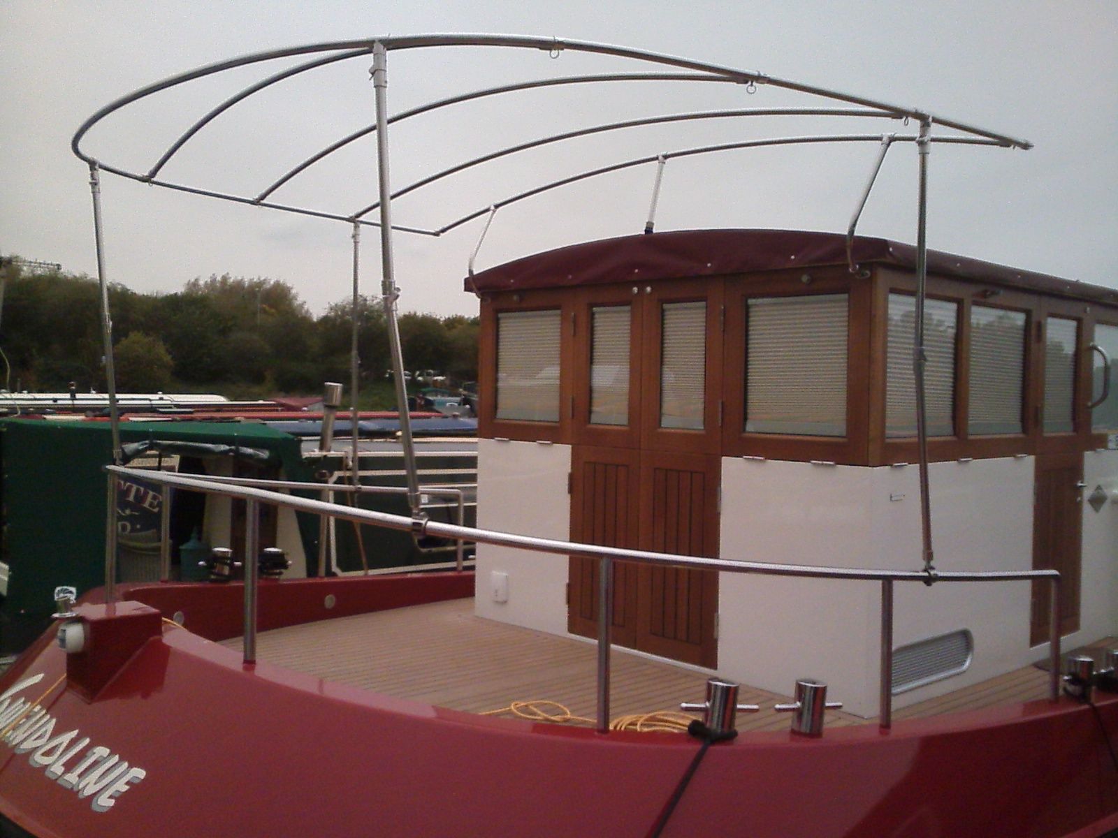

Our Pram-Hood was a heavyweight 'material' (cotton, canvas ?) that, as advised by the maker, leaked at the seams, until it got wet enough, everything swelled up and was waterproof for ever after,
Ensure you have a window in the front section that can be rolled up/down in case it is raining so hard that it gets obscured.
Ensure all the side / front / rear panels can be removed individually so that you can have a sun canopy to avoid you getting sunstroke if you happen to be cruising on the 20th July.
We had a problem with water running down the sides underneath the sides and onto the cruiser stern which we overcame by having 'skirts' sewn onto the bottom of the sides that hang-over the side of the boat.

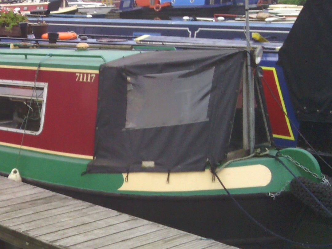

The cratch cover came with the boat and was a PVC'ish sort of material (PVC covered 'cloth') that became very, very stiff in the colder weather. I wouldn't recommend it.
