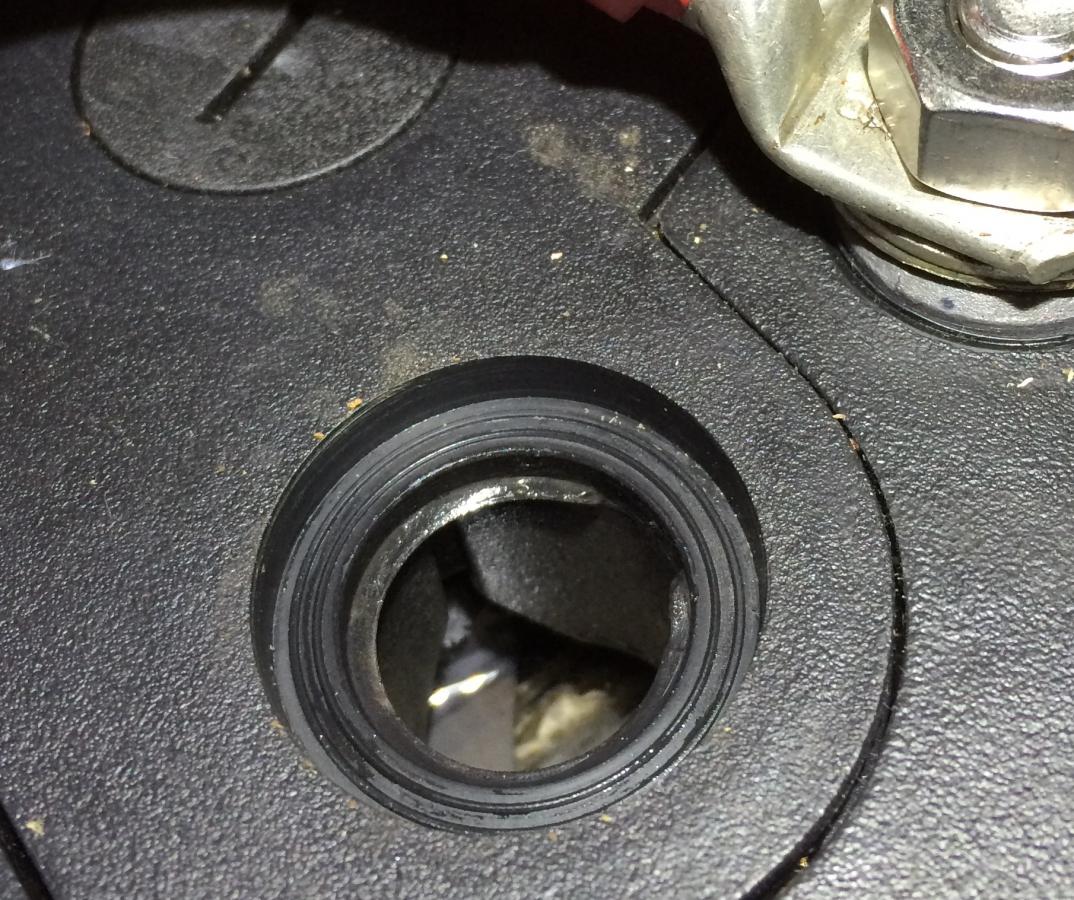

The supplier of the batteries sent me this this morning. "As long as the plates are covered this will be sufficient " Surely that's not entirely true? Does the level affect the capacity?
Does anyone have the same batteries? All the literature I read states 2 things Fill to 1/8" below the bottom of the vent well and the other is DO NOT OVERFILL. There is no specific literature on my batteries but I am unsure where the bottom of the vent well is. I have tried to take a pic but its not that clear. I have also drawn up how it looks, . The current water level is sitting just below and above point A. Any Idea where I should top the water up to? Thank you
