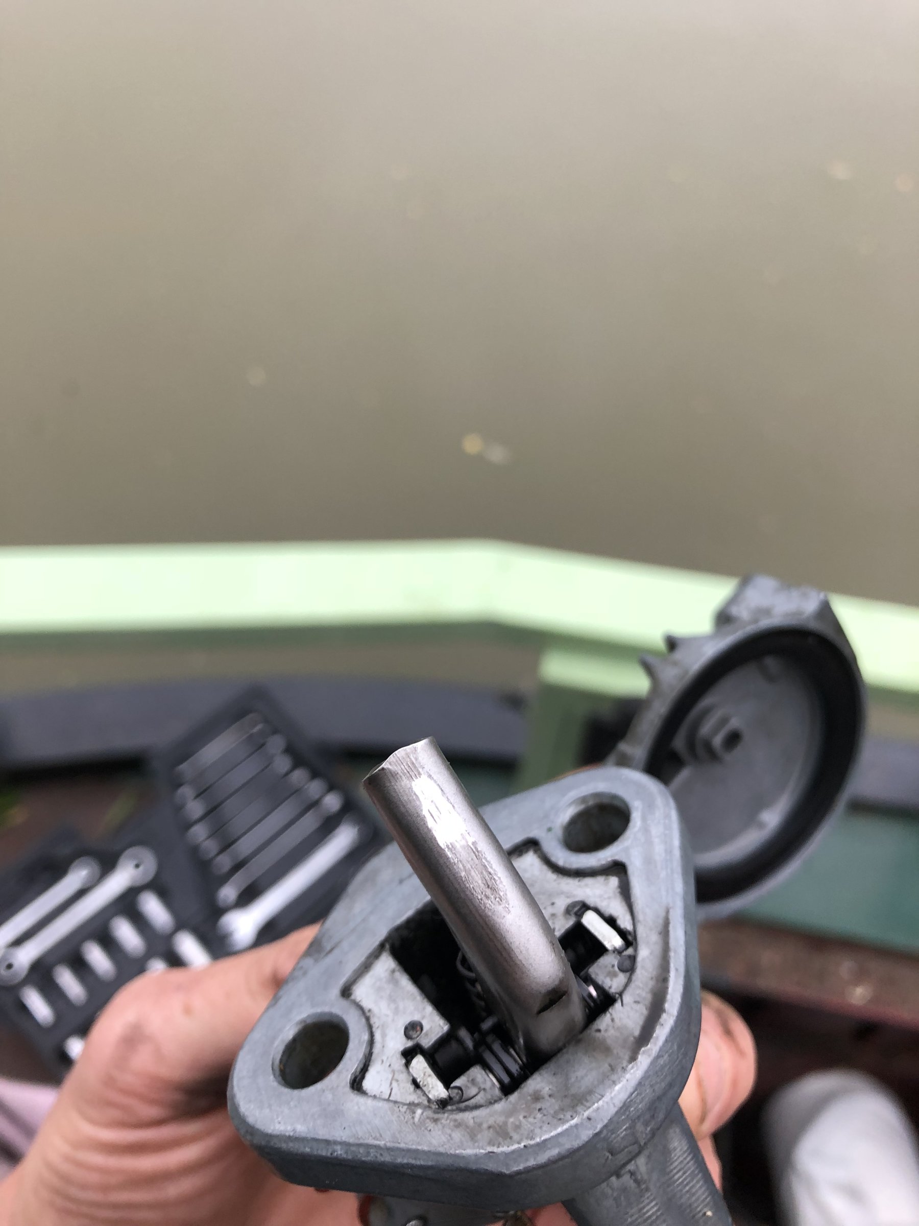

Cheer Biz. Previous picture was of the new pump, the rough marks are from a machine op to make the contact face flat I assumed. The last picture shows the wear mark on the old pump, contained only to the upper portion of the flatted section. I've arrived at the same conclusion as your post. I'm gonna crank the engine over to where the lobe is most proud (in the direction of the pump) then space the pump out. Then crank it over and feel if its pumping. Also gonna speak to Rollo power again, very helpful guys and they may have access to a drawing showing if there's indeed a spacer - so the guy thought. Oh, yer had a look inside and cranked it over by hand feeling the cam. Nothing is wrong in the engine -

My thinking is that the old lift pump installed with the thin (hand cut) rubber gasket never really did any lifting - hence why I couldn't get the engine primed properly and started without easy start. Thinknign that once primed the injection pump was able to run on the gravity fed fuel pressure... Will line them up when I get home, but I'm fairly certain they are identical. Will get some pictures of the cam through the hole too. Will also make sure that I turn the engine through two full revs and try at intervals to fit the pump - to see the difference between arm contact -

Yer this is my current thinking. That there's some sort of spacer missing. But, I would have assumed without the spacer, with the pump too close to the cam it would wreck the pump. No, but I can show you the grind mark on the new pump... The wear mark is in the same place as the grind -

Thanks for the reply. 1. Yes, I understand this, as I said in my post the lever is being actuated to it's full extent upon installation. Both the new pump and old do pump when in hand, just not when installed. 2. When installed and with the engine turning over the pump isn't being actuated. Finger over the outlet, no pumping of air. 3. I considered this and cranked the engine round abit but the installation was the same. I will try this more when I get home. 4. As stated in the previous post the witness mark is on the outer face of the old lever. 5. The pump(s) have been on and off about 5 times at this point! As I said previously I've split open the old one to see it was working - and to understand how it works. 6. It cannot be a worn cam, the lever is pressed to the maximum 7. It cannot be fuel related at this point, nothing is connected. So, the lever is always actuated I think, if I had a second pair of hands I would have the engine cranked while measuing the cam / eccentric movement. It seems to me like the lever arm is too long... -

ok new pump wasn’t the answer. Both pumps exhibit the same behaviour, the pump lever is actuated to its maximum of the stroke upon fitting. This means that the pump doesn’t do any pumping obviously. With the pump fitted loose, as in the video, I have cranked the engine over and the pump does not wobble about as you would expect to if the cam lobe were actually moving the lever. The wear on the lever of the old pump is on the outermost face. The old pump also has a makeshift gasket, so it has been removed at some point. My current suspicion is that the old pump has never worked properly and is currently fully functioning but isnt being installed / actuated correctly -

Cheers, I've already had it off and in pieces once. I didn't look for a witness mark on the lever, however the lever seems to function by being pushed into the lift pump body. With my finger I could feel the cam at the same height as the pump lever. Actually thinking about it, the pump is mounted on studs, so it can only be fitted on one axis. Part number was ULPK0018 if anyone else happens to need a 2 bolt pump for a '71 3.152 engine. Got it through Rollo Power in the end, diperk didn't have the correct one on the computer, but Rollo investigated the microfiche drawings to find the correct one. -

Just a mini update. Checked that the return and other lines are clean. Fitted the new filter (singlar). Unfortunately I discovered that the lift pumps manual prime lever has worn around the spindle, so it only actuates the diaphragm a tiny amount once bolted to the engine. In addition when being cranked the pump still seems to fail to draw any fuel in. So, new one is due today and hopefully I'll be up and running again this evening - so I can get out of this shallow and smelly pound nr Slapton! -

Ok quick update before I got brush me teeth took the lift pump off (lube oil everywhere) and split it open to understand how it works and look for faults (diesel oil everywhere) it it works fine on the cam lever, and the manual lever also works, but only at the very very end of the stroke. Fuel line (which is uninterrupted from the tank) was only dripping. So I tried sucking, couldn’t get much juice out. Blew back and bubbles the tank to clear any blockage on the pickup. Now is free flowing. Gotta get back to the office now, but I suspect this was the issue. New filter will be fitted and should be up and running tomorrow (rock climbing tonight not messing with this again!) cheers again for all all the help -
