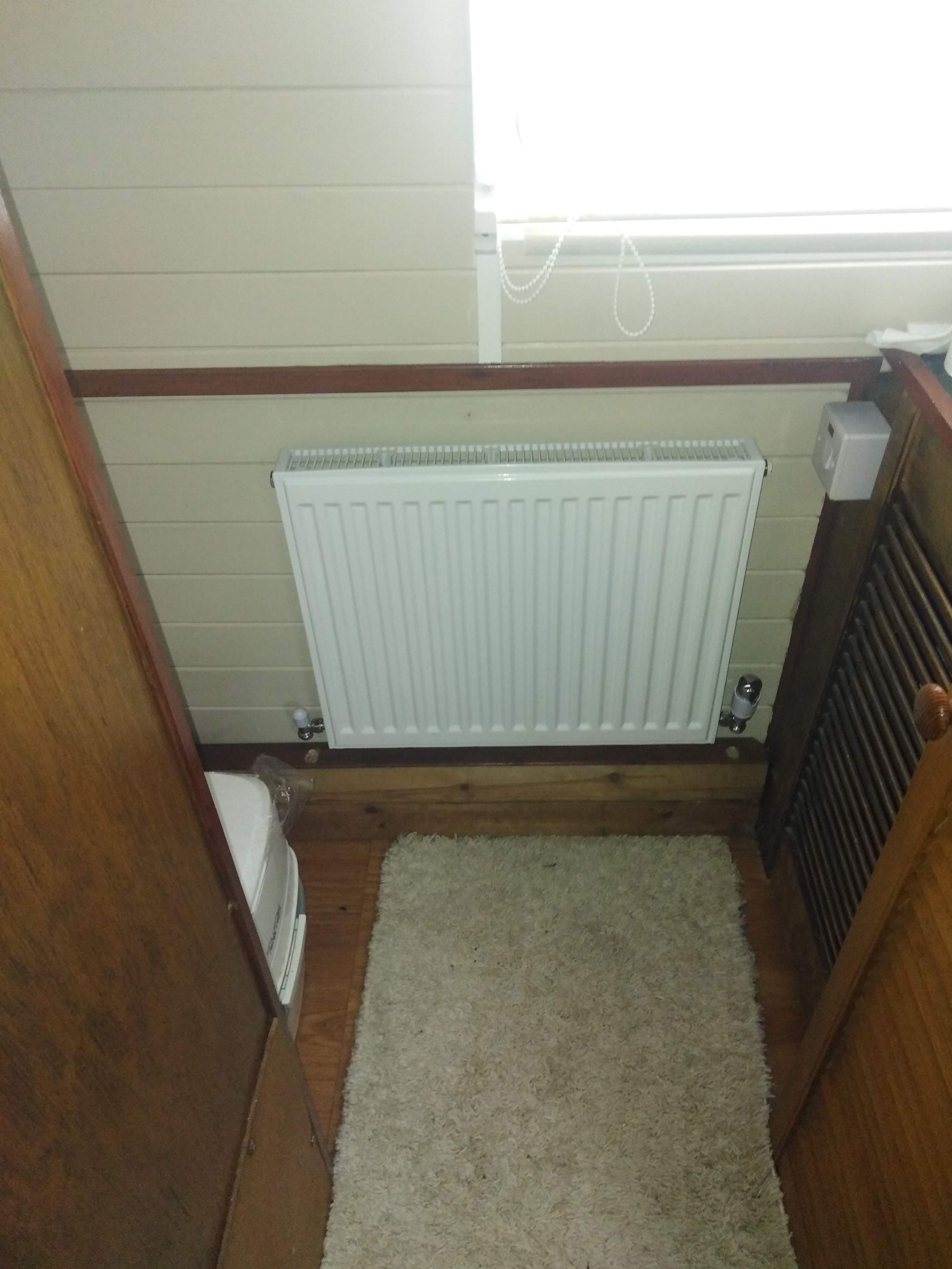

Thank you all for your replies, you have all been a great help and the radiator is now plumbed in and working fine without an inline valve. It is now toasty warm in the bathroom once the engine has been running for half an hour. By the way the fill up is via an open vented expansion tank on the wall in the engine room which is higher than any other part of the cooling system. Thanks again, keith
Hi All, radiator fitted to the wall, 5/8 16mm heater hose purchased, T pieces 16mm, circlips and small piece of 15mm copper pipe purchased to join the valves to the hose at the radiator. My final question before cutting into the return pipe from the calorifier to the water pump is, Do I put 2 T piece joints into the return coil hose from the calorifier, i.e 1 hose coming from either end of the radiator ? (Would this increase the chance of water flow through the radiator ?) Or do I put 1 T piece joint in the return coil hose, then T off a single pipe route either side of the radiator ? I'm just struggling to understand how any flow of hot water going through the radiator can be achieved by T ing into a single return hose to the engine. Will it just be a case of 'radiated' heat finding it's way into the additional water capacity of the engine, coil, radiator and skin tank. Thank you for your replies, keith
Would the radiator not get any radial heat, the rubber hose inside the skirting board certainly feels quite warm when the engine has been running. To put the radiator into the engine return hose, ( would I then need to T off that hose in 2 joints) with a flow and return pipe? I understand that car heater hose would probably do the job, but want to avoid to many hoses coming through the engine room wall/inner bulkhead frame.

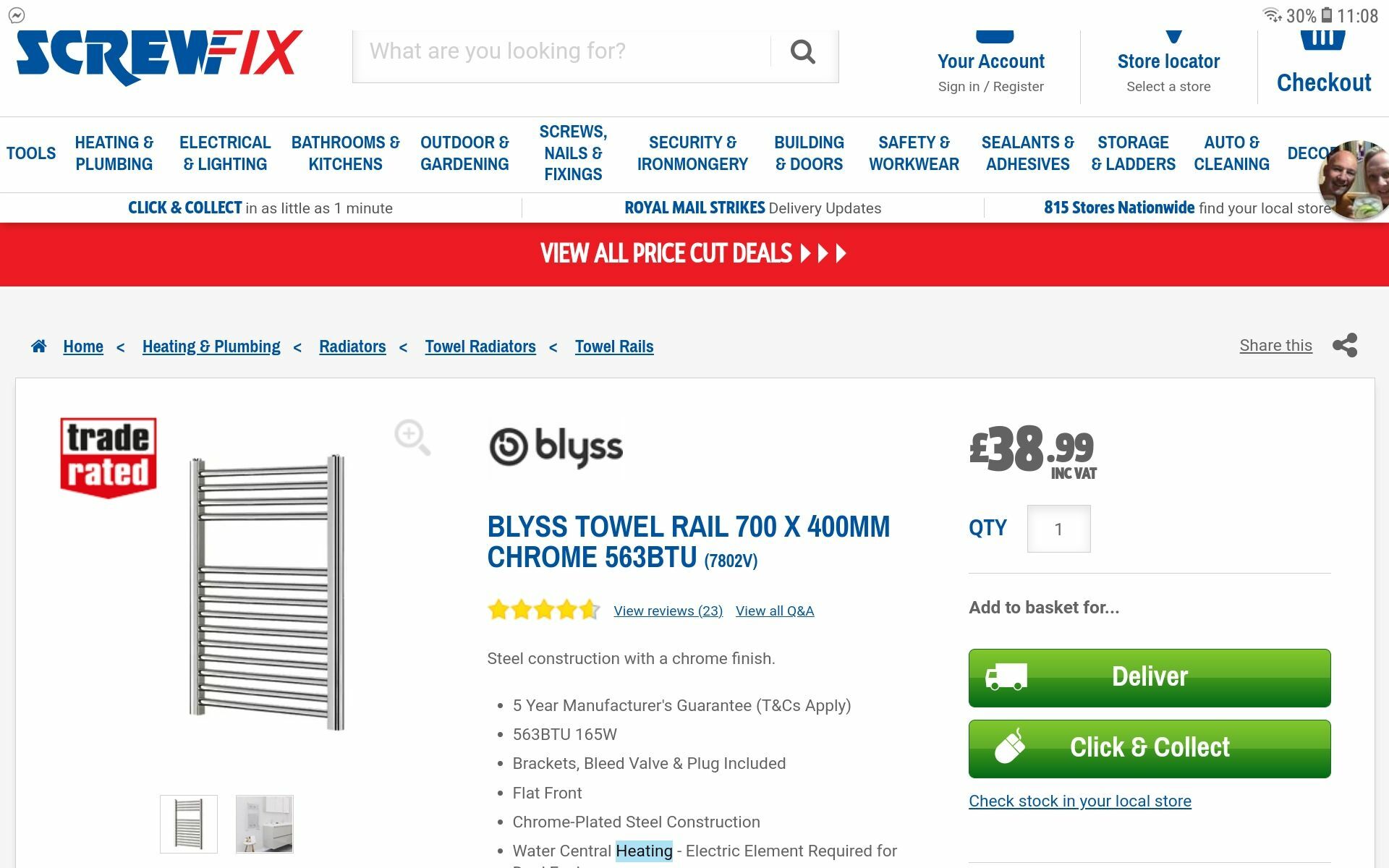

Hi All, There is currently no heating on my trad boat with the exception of a multi fuel stove, the bathroom in the middle of the boat needs a bit of warmth adding. The engine is a Lister HRW2 with a small calorifier fitted, the piping from the calorifier routes through the bathroom at skirting board height en route to the bathroom tap and galley hot water taps, and I'm thinking I might be able to put a small towel rail in the bathroom by re routing the flow of water via the towel rail. Obviously it the hot tap system. Currently the hot water is piping hot even after an hour of running the engine, there is a skin tank on the other side of the boat and the engine is in it's own mid boat room. And if so should I 'T off' the radiator/ towel rail so that it can be isolated/ turned off if necessary.
