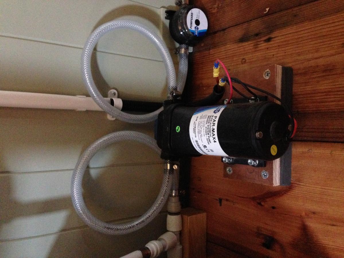

Charger 29v bad for Water Pump?
NorthwichTrader replied to NorthwichTrader's topic in Boat Building & Maintenance
There is no enclosure as yet. I can reveal though that the pump is on rubber feet, which are fixed to the plinth, and the plinth then screwed through a double sandwich of soundproofing foam. I think I'll give the engine mounts a whirl and see what effect they have. Many thanks for the diode thread. I'm just a little put off by the voltage being reduced to below 24v when the batteries are not on charge. I'm guessing the pump would struggle at these lower voltages? -
Yes, Nick, there are plenty of improvements I can make re the sound proofing! I will look into some proper engine mounts too...saw this on eBay (291516045186 - sorry, can't link on my phone), so might give them a try! Thanks to everyone, I'm reassured to know it won't knacker the pump, which is 24v I hasten to add! -
I'm typically charging the batteries overnight, and switching the charger off in the morning. However, my wife leaves for work at 6am so, despite the best intentions, we do get a major wake-up call!Also, every time the pump runs, it chucks the charger back into 29v for 30 secs or so, which means the second cycle of the pump, even if it was started in the float mode, is at 29v. -
Thanks SO much, chaps, never disappointed on here! Can I ask how easy it would be, or whether it's even possible, to put something inline on the water pump that restricts the voltage to it to say 24/25 v? I only ask because it's a tad noisy, even at 25 v, but at 29 v is giving us all a nervous disposition! If it's complicated I'll just buy 3 sets of ear plugs! -
Many thanks for that, that's extremely reassuring. I've been meaning to ask for such a long time! Brilliant! ? -
Hi, Things are moving as slowly as they ever have with my self-fit-out. I'm currently keeping my batteries charged by using a numax charger (24v). However, when it first starts charging, the voltage shoots up to 29v and I think it then floats around 26/27 (I forget which)? Does anyone know whether this, apart from driving the water pump at a million miles an hour, cause it any long term damage? Does this happen when you charge your batteries via a combi unit? Many thanks, Stuart
