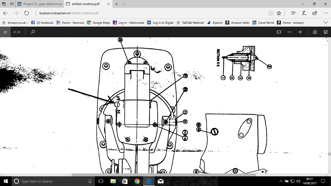

  13. The worm drive to lift the leg is on the left on the 2nd photo. I suspect that you will have to unbolt the steering arm when you start to swivel the leg. If you use a slipway it is important to swivel the leg to avoid damage. I removed my leg in the water but had to ballast the front of the boat to lift the fitting out of the water. Then I sent it by Red Star (rail) to Bob Knowl's at Leicester he repaired it, replaced the broken yoke and most of the gears drove down to Skipton and refitted cost £1000. 1985.
  14. www.chertseymeadsmarine.co.uk/enfield-drives/ lifting the z drive will not solve your problem. Disconnect the gear cable and attempt to move the leaver on the drive itself. The locking pin will be on the right side looking back level with the drive shaft. www.boatservicehaarlem.nl/enfield-outdrive.pdf . You can see the locking pin looking from the back of the boat. arrowed.
