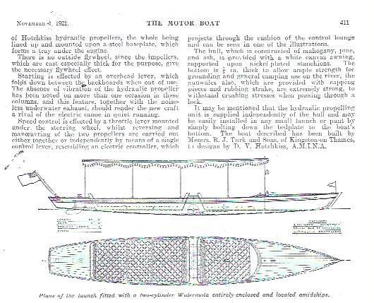

In 1921, just a few years before his Cone invention burst upon the world of marine propulsion, Mr Hotchkiss, through the company incorporated for that very purpose, produced a new system of propulsion by water jet, which he named the Hotchkiss Hydraulic Propeller.
Technical details of this system, if you are interested, are to be found in Engineering Jan 4 1924 pages 13 and 16, but a short description, taken from Motor Boat's report of the 1922 White City boat and leisure show, will perhaps be enough.

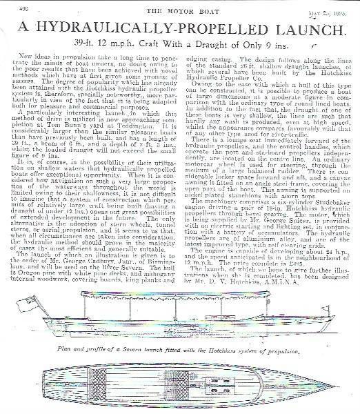

Some Hydraulic Propellers were fitted to a few small vessels, and several were sent abroad, but its success was not immediate. Mr Hotchkiss then designed and had built a series of shallow draft river launches with the system, which he claimed were suitable for rivers such as the Thames and the Severn and others. These launches did achieve some sales and I have included details of a few of them below, taken from the Motor Boat. The illustrations and descriptions speak for themselves, but it is worth mentioning  in particular the launch 'Torfrida'. The reports state that this was built to the order of Mr George Cadbury Junior of Birmingham. Mr Cadbury was a firm supporter of canals and inland waterways. He was the co-author of the Pitman's Transport Library's book on the subject of canal transport. But I have found no mention of the boat's use by Mr Cadbury, or how and if at all he used it on the Upper Severn. So we cannot gauge how successful the boat was, or how any of the Hotchkiss launches were used, and for how long and of what became of any of them.
