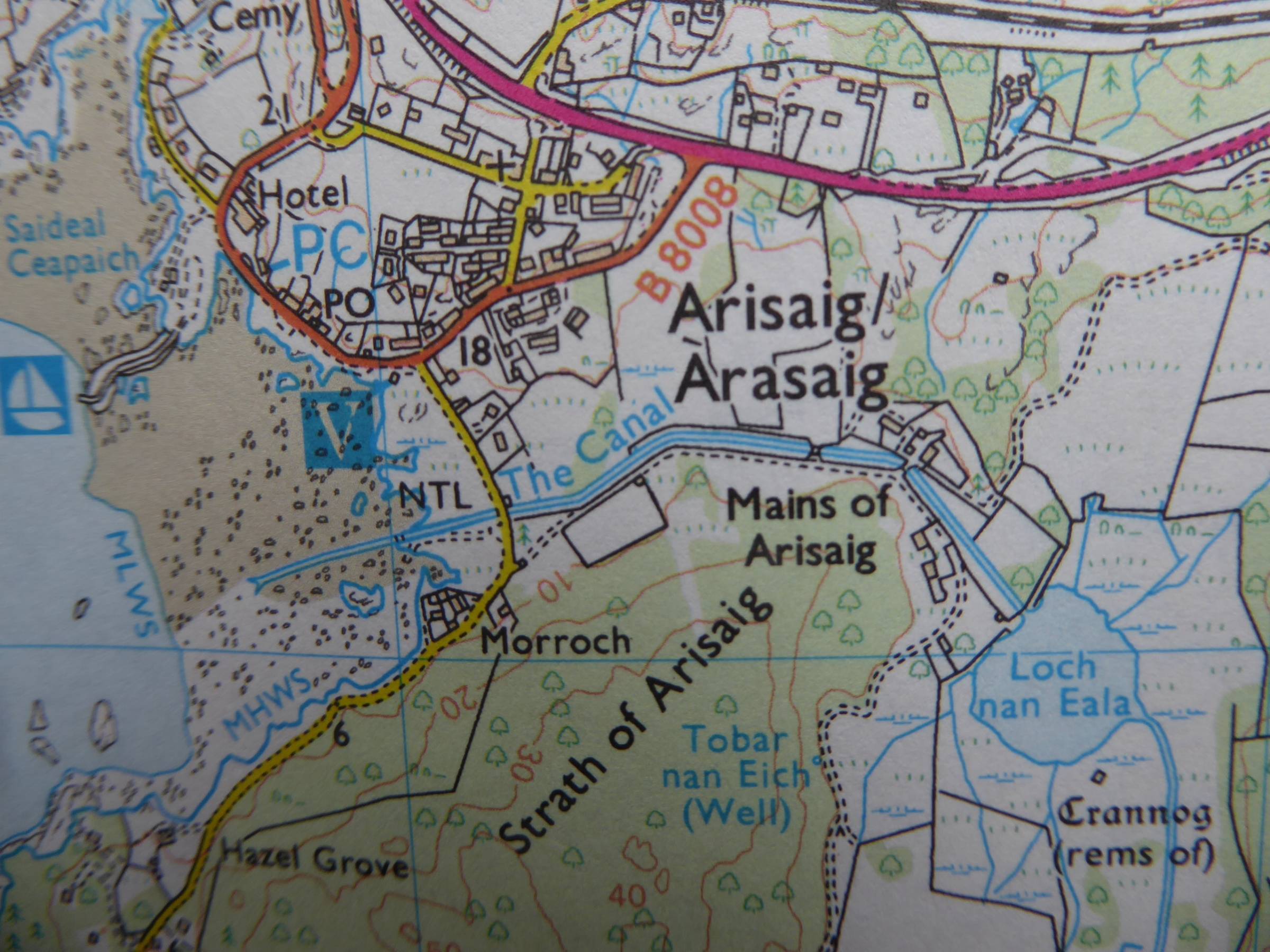

Oddly enough the map which shows the most engineering features is not the historic OS 6" but the latest 1:25000:
From west to east:

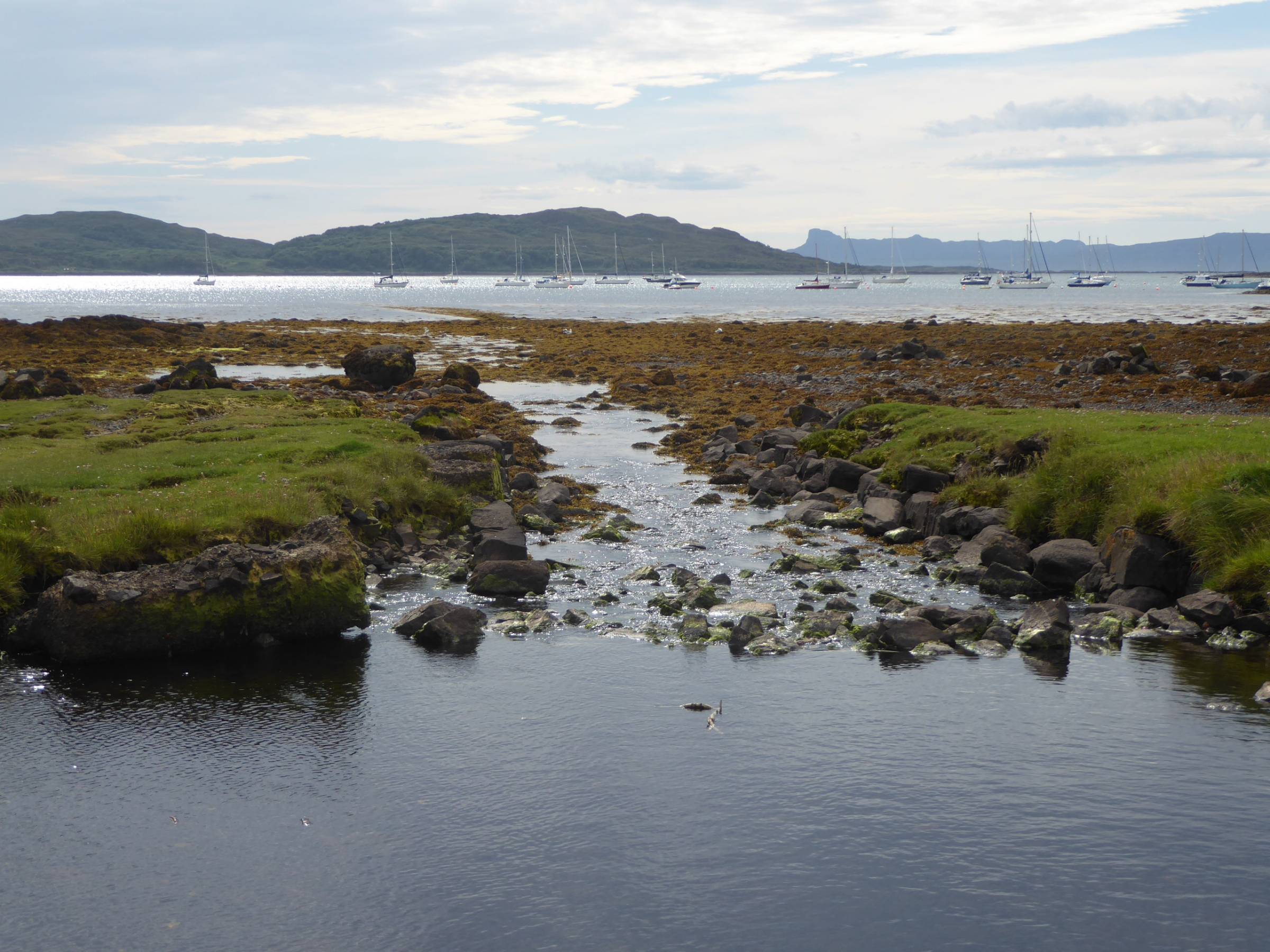

1. At the high water mark there are remains of concrete abutments
2. Bridge carrying the road to Rhu

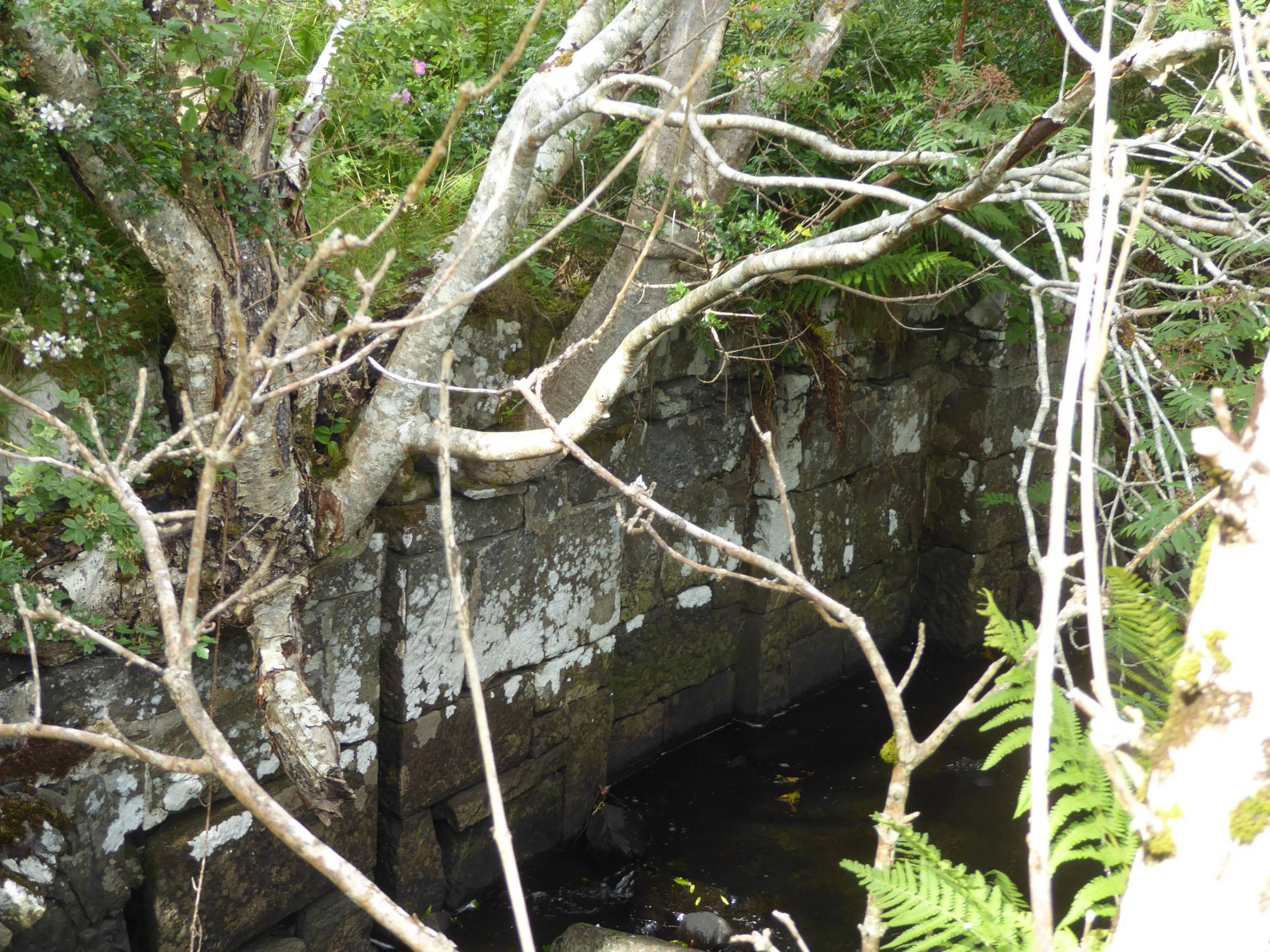

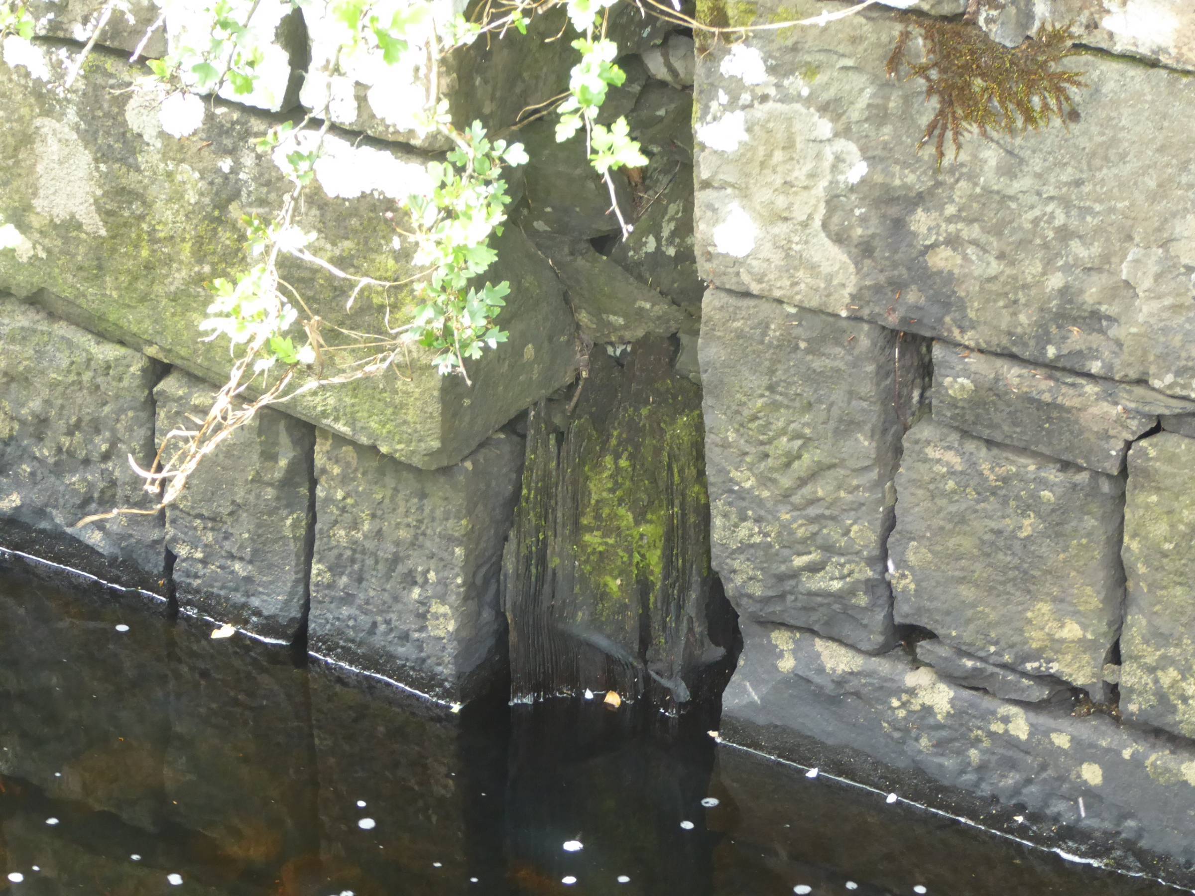

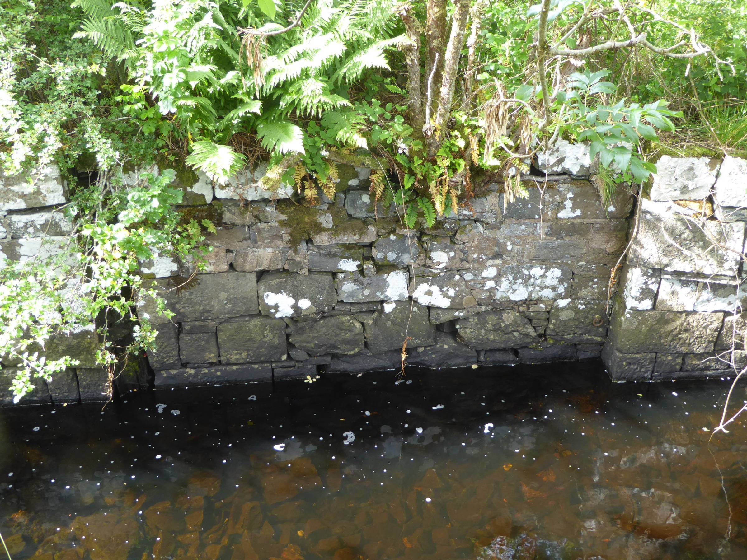

3. Not on the map, immediately east of the bridge, the "old sluice gate" has a recess on the north side for a single gate, with vestigial remains of a wooden heel post(??), and on the south side, a rather small rebate it would have closed against; this side also has what looks more like a stop plank groove, but rather narrow and running deep into the side wall. 27 paces further upstream the same is more-or-less repeated, making the construction resemble a pound lock. The "chamber" is, like the rest of the channel, part masonry and part cut into the rock.
4. Only the concrete abutments remain of the footbridge marked, some supporting wooden beams were still in place in 2017. More info and lots of photos here:
https://canmore.org.uk/site/277550/mains-of-arisaig
5. A little further "upstream" and now quite close to the sawmill (the curving cart track leads to it), is a widening on the north side which looks like some sort of loading facility. This is also not explicitly marked on the OS map.

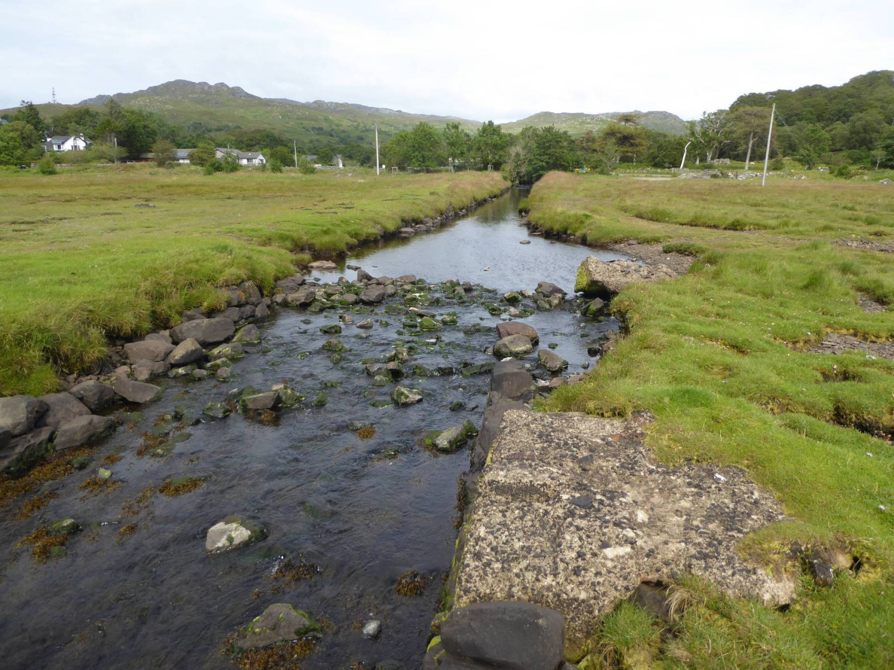

The extension of the canal below the high tide mark and the remains of the concrete abutment:
Lower gate recess and timber heelpost remains:P1050409.thumb.JPG.3a3d05b371af7170d0ba74ec965d48ff.JPGP1050411.thumb.JPG.46c440dfe8eee858f0dbd93375b2edb6.JPG
Upper gate recess - but here the heel post end looks more like a stop plank groove:
