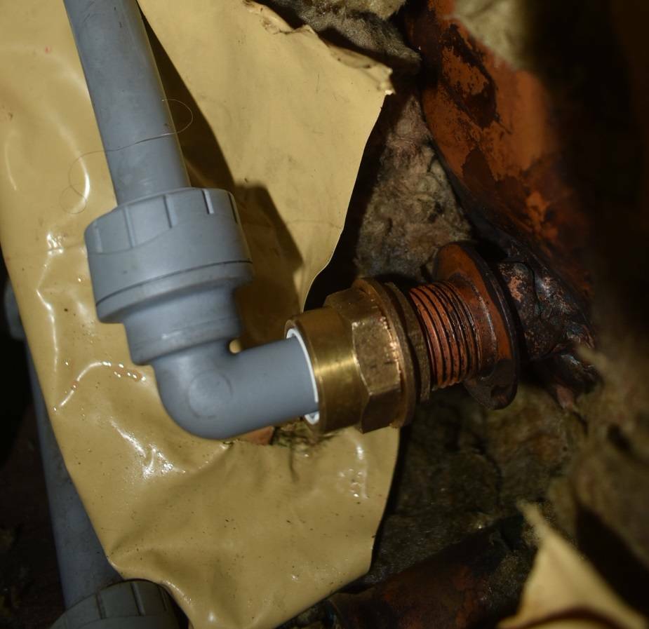

Scholar Gypsy Posted February 13, 2024 Author Report Posted February 13, 2024 Mark 2: rather better made fittings, which came with both flat and tapered washers. I also added a lock nut, to avoid overtightening. So I really don't think this will move again..
MtB Posted February 13, 2024 Report Posted February 13, 2024 11 minutes ago, Scholar Gypsy said: Mark 2: rather better made fittings, which came with both flat and tapered washers. I also added a lock nut, to avoid overtightening. So I really don't think this will move again.. And yet... there are droplets of water visible on the yellow plastic sheet behind the fitting in your photo!
Scholar Gypsy Posted February 13, 2024 Author Report Posted February 13, 2024 1 minute ago, MtB said: And yet... there are droplets of water visible on the yellow plastic sheet behind the fitting in your photo! That was from when I removed the previous fittings. Most of the coolant had been drained into a bucket in the engine room, but not all.... The lagging is also a bit soggy. Any leaks end up in the cabin bilge and are very easy to spot.
