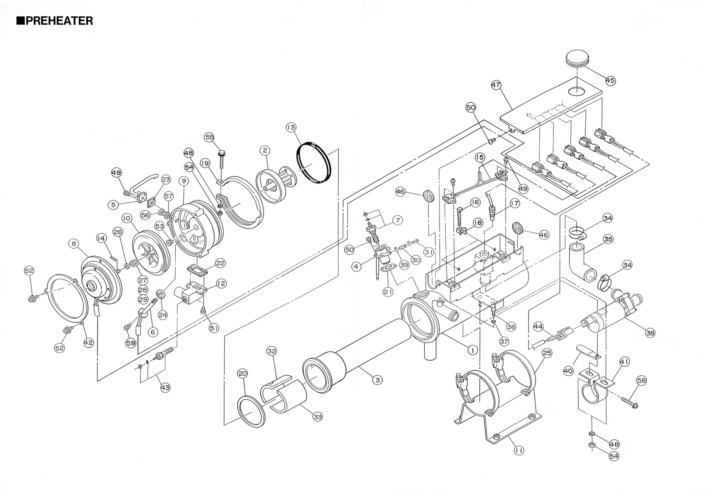

Hi Folks
My Mikuni MX60 is running well and keeping us toastie warm, which is great.
The only 2 issues I have are
1.  The burning isn't as clean as I'd like, the exhaust is smokey most of time, for example on coming back to the boat in the dark you can see and smell lots of diesel smoke in torch light.
2. The exhaust noise is loud
Regarding 1. (smokey burning)
I have given the unit a good intrenal cleaning but thats made no difference.
I suspect the wicks are next thing I need to replace to see if that helps.
Firstly is that a sensible conclusion ?
Also if I go down that route what else should i be doing whilst I am at it ?
What parts should I be buying other than wicks A and B (533668 and 533669) ?
Regarding 2 Noisy exhaust
I don't appear to have an exhaust silencer (muffler). I huess that would be the first thing to fit. On checking for the part 533598A I can't find that exact part, however MV Heating list a 22mm and a 24mm muffler, will either of these fit the MX60 ?
Best regards
Frank

My MX60 on my barge was always a bit smokey and I never got it as clean running as the smaller MX40 that I had on a previous narrowboat so I can't suggest a guaranteed cure. However some experience of working on my MX60 is as follows (bear with me because it is a few years ago since I last worked on one):-
1. IIRC the heater plug holder is a very tight fit into the body of the heater and, IIRC, uses a heat resistant sealant when reassembling. Have a look at an MX60 manual for guidance. The heater plug was so tight on mine that I had to make a special puller to extract it cleanly which I left on the barge for the new owner when I sold it in 2017. Trying to lever it out just bends the retaining flanges, unlike the MX40 which is so much easier.
2. The wicks are a very tight fit into the body of the heater. You have to carefully align the hole in Wick A with the heater plug holder hole while pressing the wicks into place. You should also get the heater plug holder gasket (Part 21) if you do this job
Overall I found the MX40 easier to work on than the MX60. There is an adjustment on the MX60 IIRC that allows you to alter the air/fuel mixture ratio but I never had the required gas test equipment to be able to investigate that. That's what Shims 27, 28 and 29 are for IIRC. You might be able to get a gasket set for it to do the job but ask Mikuni about that.
If you find all this a bit daunting there used to be a contributor to the forum IIRC who was an accredited service agent for Mikuni but I don't think I've seen him post for ages to the best of my knowledge.
The Mikuni Heating UK technical guy that I always found very, very helpful was Steve Elliott on 023 8052 8777 (Again, it is some years ago, maybe 2015 - 16, since I spoke to him so can't be sure if he is still there)
Hope this helps.
Roger
