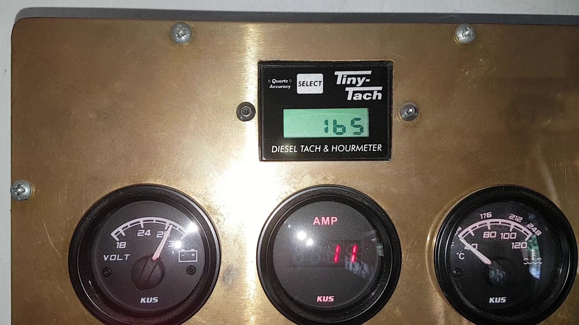

I bolted a 630mm twin v belt pully to the outside of my flywheel (K2) to drive a single 70amp alternator and also fitted an ammeter so I always know what my alternator is doing. Regarding  fitting a rev counter, I have a Tiny Tach which picks up a signal from one of the fuel lines which seems to work well.

Which size Inductive coil do you have on the fuel line? The 6mm or the 1/4”
I'm not on the boat so cannot measure my fuel lines but I'm almost sure it was 6mm (it was fitted about 3 years ago so cannot remember what size I ordered) - the fuel lines could have been replaced at some point so I would recommend putting a vernier gauge on your fuel lines to make sure of the size. Also you need to state the voltage - I kept all my electrics at 24v to keep things simple.
I purchase from a UK company called I.T.C.O. but I have just looked them up and found no trace of them on google but I still have their contact details on my phone so maybe worth a call: Richard Dunn 07860 323255.
