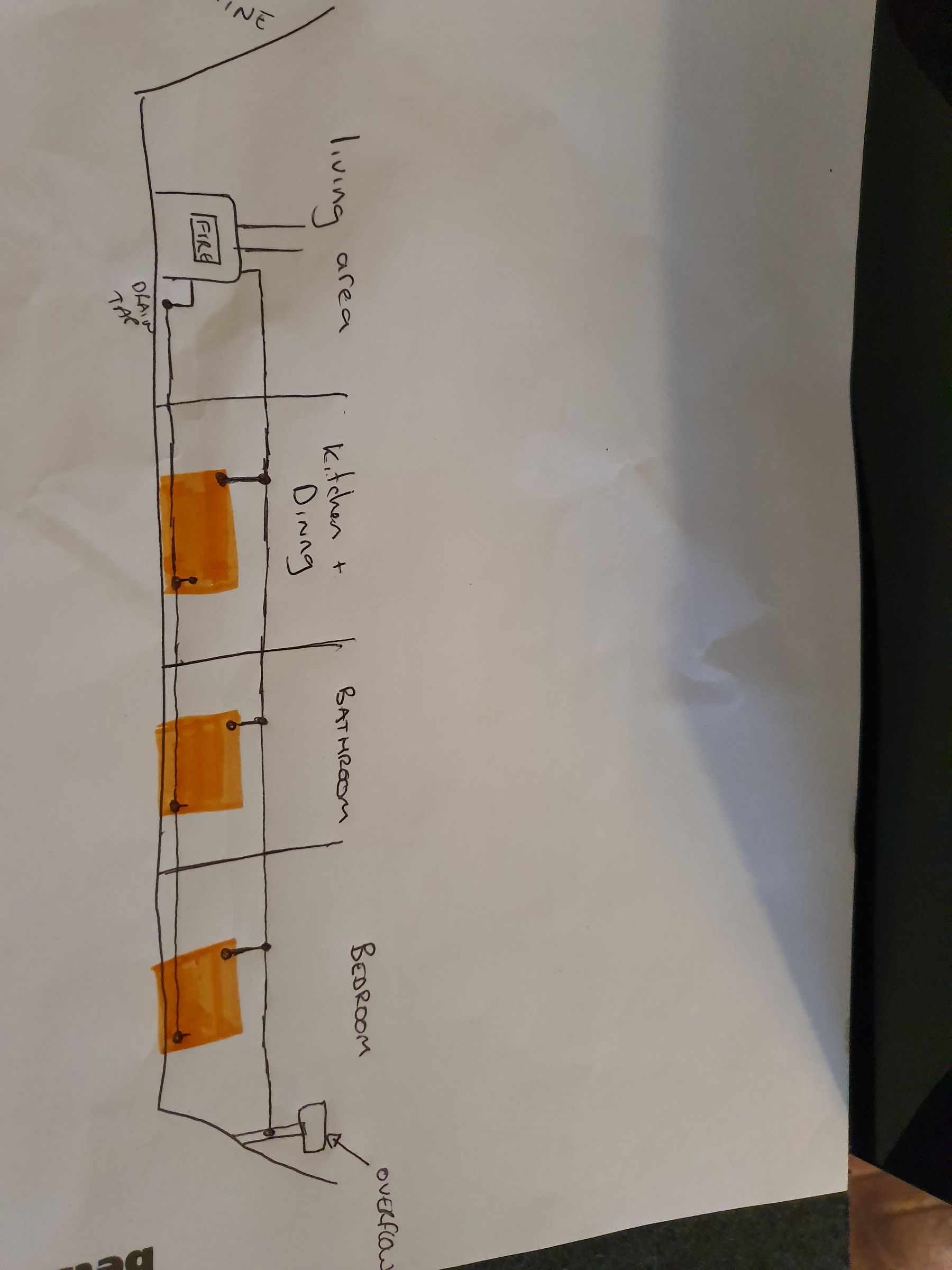

22 hours ago, Tracy D'arth said:
Back boiler flow [top] pipe [22mm minimum] up to under the gunwale, along forward with 15mm pipes dropping to the top connection of each radiator and on to the bottom of the expansion tank, [ where you can fill the system, ]  [what you have as overflow,]  in 15mm which must be higher.
Return from bottom of each radiator along floor into 22mm again back to the return [lower] on the boiler. Radiators most efficient with top and bottom connections diagonally across the radiators.
Golden rule, flow pipe must rise away, all the way, form the boiler and return must fall towards the boiler. Easy with your layout because the bow of most boats is higher anyway.
Drain tap at the lowest point.
No pump, no electrics, safe providing the radiators a re big enough to take the output of the boiler.
If calorifier is required as well, same 22mm pipes to boiler from calorifier with a vent valve at the high point on the calorifier.
Thanks for this it's starting to make sense.
(Sorry for the drawings but just find it easier tk get my head around)
Have I got your explanation right?
From the drain tap it will have to go up to the stove is this correct?
Thanks dean
Thanks dean
  Yes. that is correct, up to the return, lower, connection on the boiler.. You have got it, well done!
