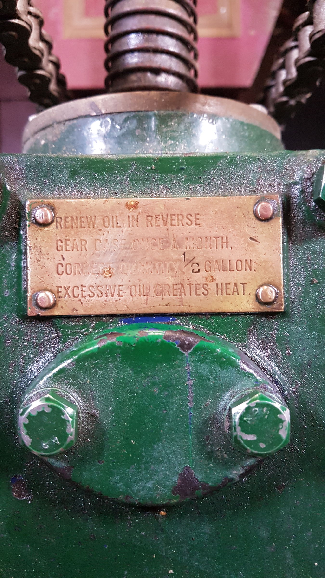

The brass plate states: Renew oil in reverse gear once a month. Correct quantity 1/2 gallon. Excessive oil creates heat.
I think it safe to assume that "once a month" refers to 24/7 use.

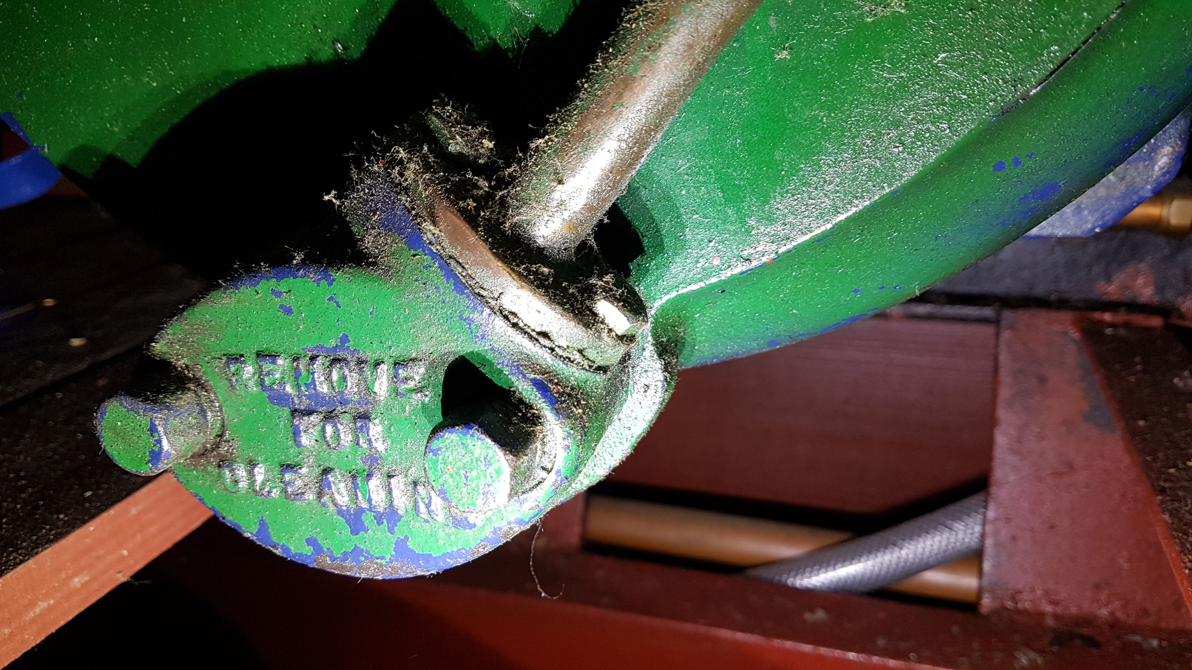

As stated, the easy way to remove  oil is by vacuum pump if you have one. If not, the level tubes connect into base of gearbox held on by two bolts which is cast with the following: Remove for cleaning (i.e. draining oil).
