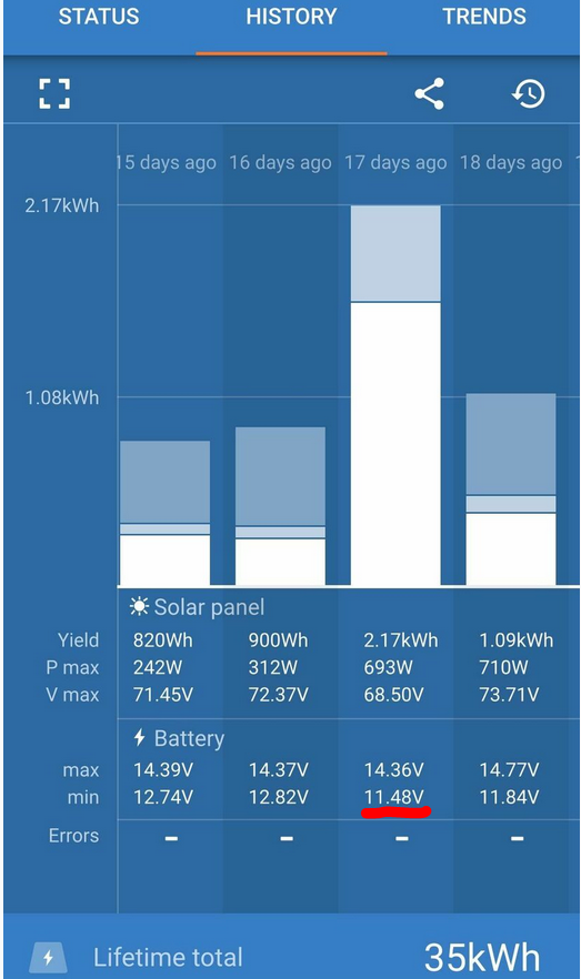

The data you have provided from the battery monitor shows that on the day where you generated the most power the minimum voltage of the battery was much lower than the other days. Therefore, the battery had the capacity to absorb much more power. See the value underlined red below. When you look at the minimum voltage over the last few days, in you other screenshot, the minimum voltage is barely below 13V, hence the batterys were unable to absorb a lot of power. Before I get told off, the voltages provide an indication of what amount of power the batteries were able to absorb. The low voltage could have been an instantanous dip when you turned on a heavy load, but if not on for a long time then the battery may not have discharged much of course!
