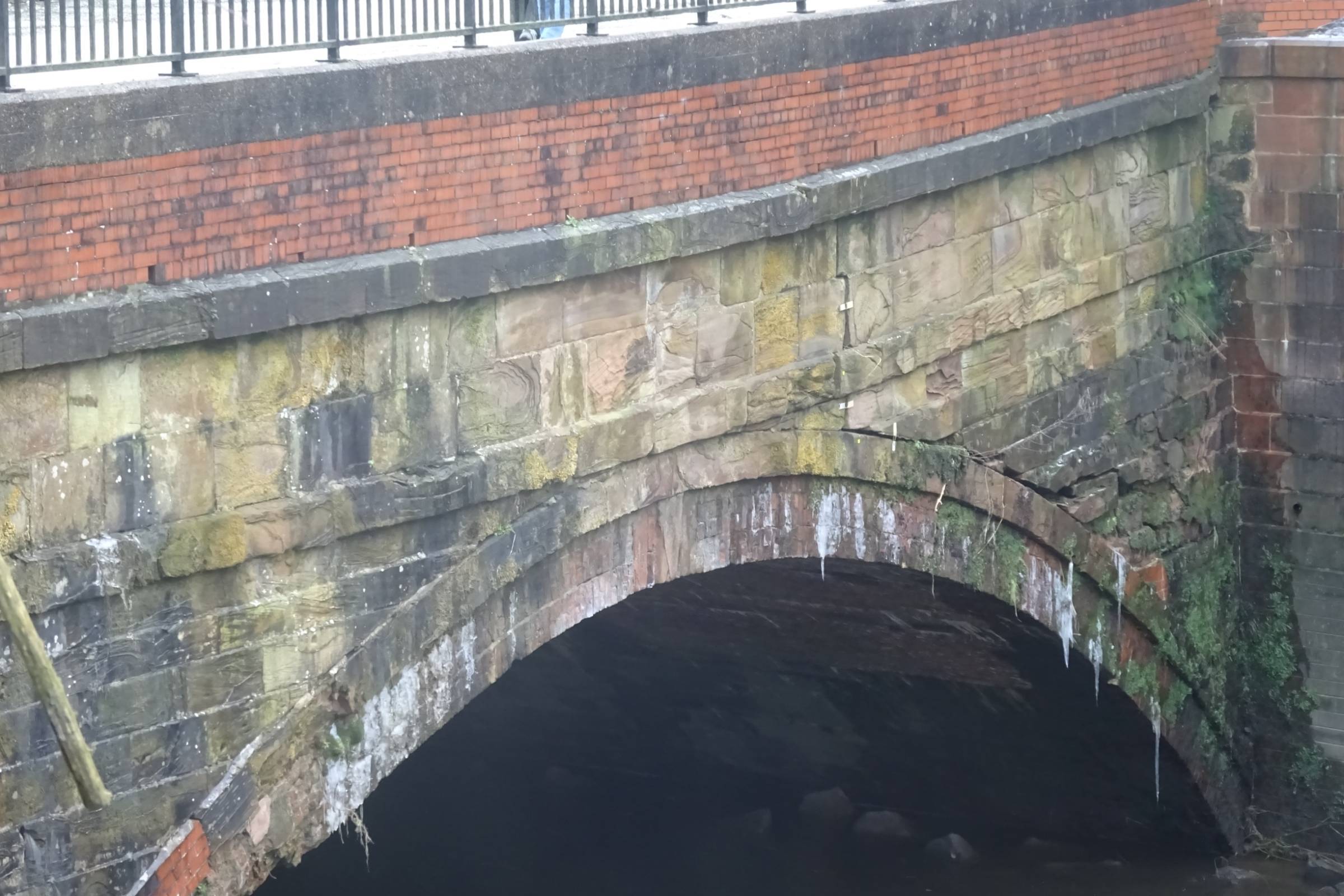

  6. The planning application is 115163/FUL/24 on Trafford councils website. It's merely seaking permission to put lots more tell tales and other monitoring studs on a listed structure. There are some interesting documents including one that suggests it has been moving since the 1800's. The flood documents attached to the application are very extensive although there is no depth gauge at the actual bridge. For my money the water that Jim is concerned about is definitely too much to be melting ground water. It does look to me as some of the stonework has suffered from frost heave in the recent bad weather.

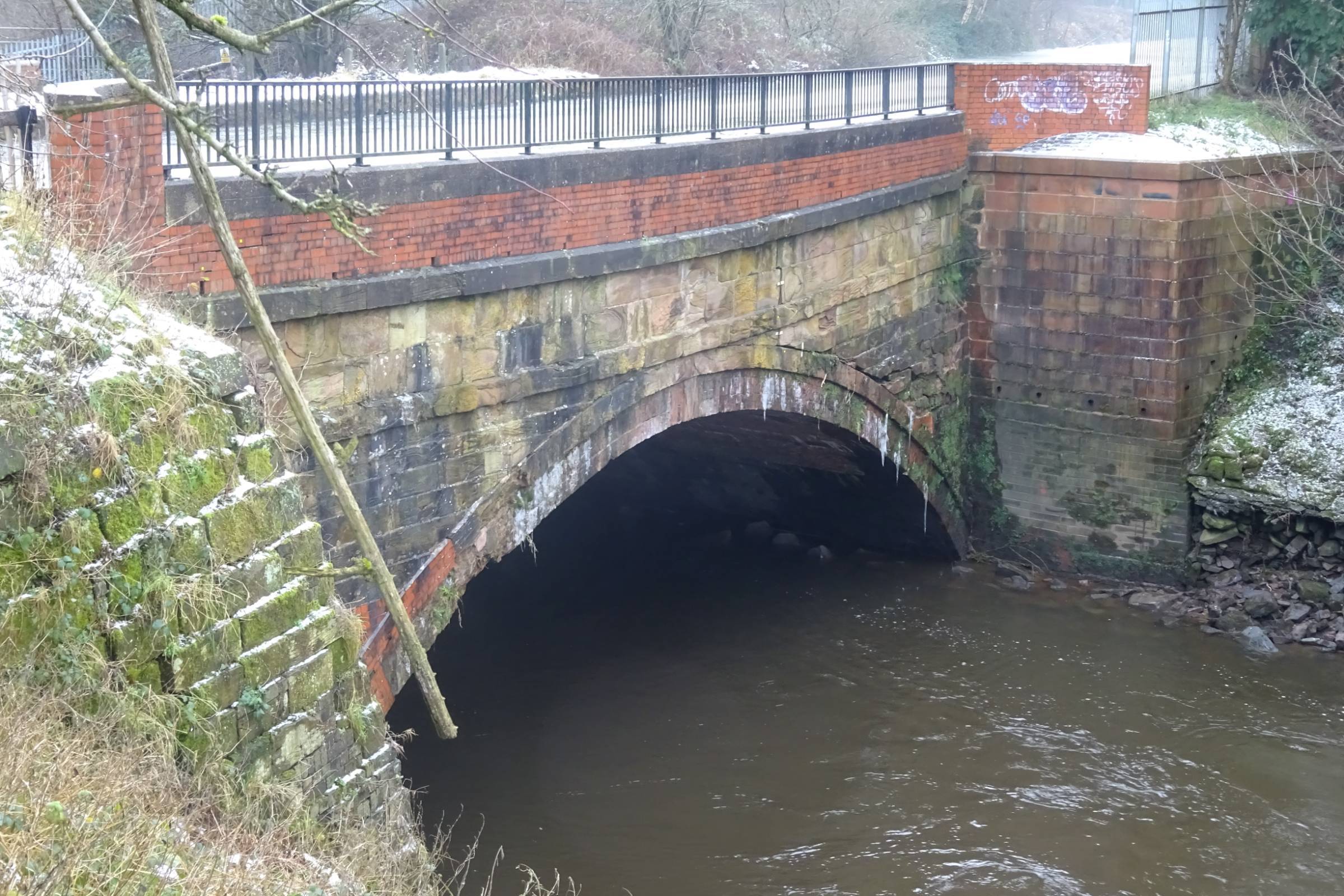

  7. Hi Wafi. There are some more pictures taken last week at the bottpm of page 17 of this thread. You can see that the arch has been sagging for some time from the brickwork which was obviously added at a much later date than the bridges construction. The main worry is the damage caused when the Mersey is in flood. The arch becomes full. Although the arch appears sound there is a question mark around the lateral forces that come in to play. The photographed wall does belly out a little. The glass tells aren't busted. They've been coloured with indelible marker I think. A couple have fallen off and left tell tale signs. It would provide Sale cruising club with a very limited cruising range!
  9. It is only a stone bridge but when it goes it will close the canal for a year or so and be another multi million pound fix. The failing structure is towpath side so if we're lucky the canal may not empty.
  10. I hope you've got Tiger moored up well if she's at Stretford Jim! 😧
  11. Here's the elephant in the room as far as any handover to CRT goes. Jim P mentioned it further up the thread. This is the bridge that carries the canal over the River Mersey. The downstream side is cracked, slumping and bellying out! As you can see the crack is being monitored but some of the glass slides have gone missing. This bridge is a bottleneck as far as the Mersey is concerned. Looking at the debris in the trees on the upstream side on New Years Day the water level was 5 metres plus higher. Huge forces in play.

  16. I can see an argument for keeping it open in that it allows traffic around the Cheshire Ring which is of marginal benefit to all the councils through which the canal passes but given that all the mentioned councils are struggling to balance their books I can't see them being very keen to chip in to the costs of the repair this time.
