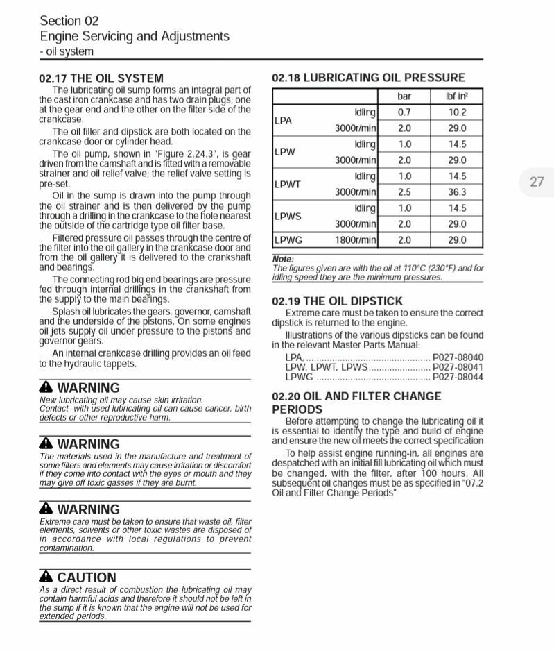

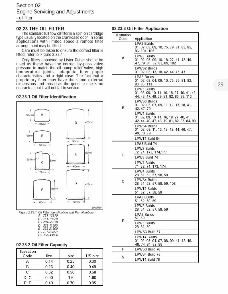

Here's a little info that may help. As you can see the Alpa engines always had a relatively low oil pressure from new and this causes no problems. Is your idle speed correct, it should be around 950 rpm under load. If it has dropped off which is quite common with this engine your oil pressure will also drop off at idle. Also info on the various filters fitted to the Alpha range of engines. Yours should be fitted with with letter B. You can check against the dimensions to see if you have the correct one. But in all honesty it will have no bearing on your oil pressure whichever one is fitted.
