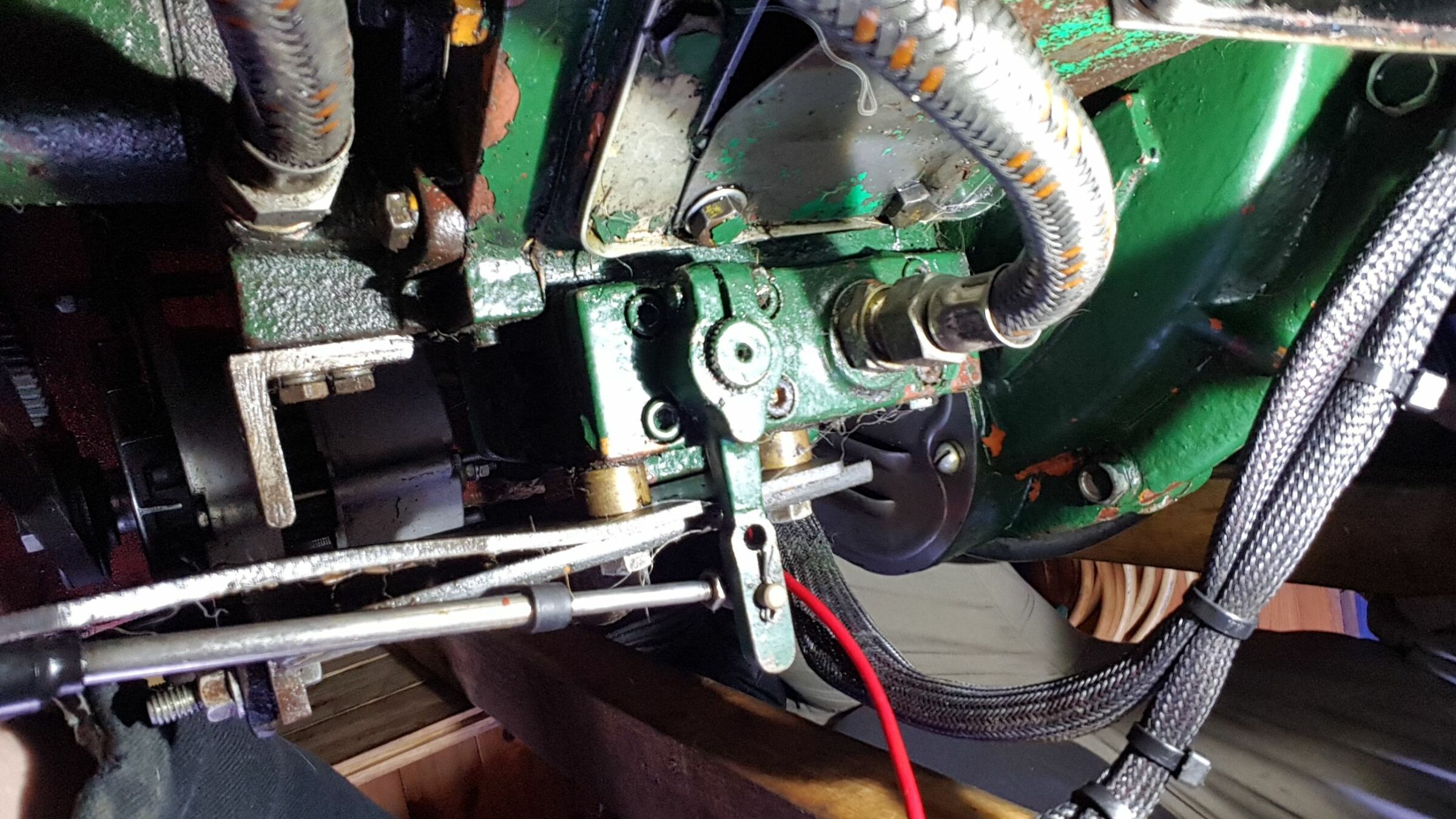

  1. Cheers Pirtek in stoke, ill try em on Monday, its funny you mentioned the banjo, when I was looking at the photo in light of Tony's comments I noticed the hose looked strained. By slackening the banjo and rotating it clockwise a bit the hose would be a lot more relaxed. The first time I remember this boat losing traction due to loss of hydraulic oil was about 5 years ago. Its been an intermittent fault but that's a hell of a lot of nappies since. An oily bilge gathers no rot; or some such nonsense but its cheaper and easier to apply than paint.
  2. anybody know someone who can make custom hoses preferably near to Macclesfield. We could take that hose off and get new hose recrimped onto the same fittings. would be cheap enough to be worth a shot even if just for elimination purposes
  3. ok a leaky crimp. id love to believe it. all the joints on those hoses have bits of clean rag wrapped round them to just in case the gearbox finally wants to tattle tale where its leaking from. i admit that it would be an immense help if i had the foggiest idea how a hydraulic gearbox worked in the first place.
  4. that photo shows the oil cooler hoses and itsd even the right way up weyhey not that it matters. the suspect hose is the one by the red wire. I dunno what it does. My own gearbox (a newage) does not have a hose here, just a brass plug which i believe has a seal behind it .
  5. that is the hose in question which rather unhelpfully has come out upside down. it doesnt go to the oil cooler it just goes back into the gearbox. The oil cooler hose is the one on the left of the upside down photo. bear with me a bit
  6. Hi I would like help with a with a Kingfisher 14D and in particular the MA 100 gearbox. The gearbox leaks hydraulic oil, not always coz that would be too easy. Only when you aren't looking. OK so keep looking problem solved. But seriously there is a hose near where the linkage that selects forward and reverse is located on the top of the gearbox. I suspect that the leak is from there (or at least one leak is from there.) Is there anyone who understands how this thing works who could give me some pointers. Preferably someone with a yard full of free 14D spares who likes working on these engines so much that they ll send me to the pub at their own expense so they can get on with fixing it gratis in peace and quiet but thats just a negotiating position. I may have to move on that.
