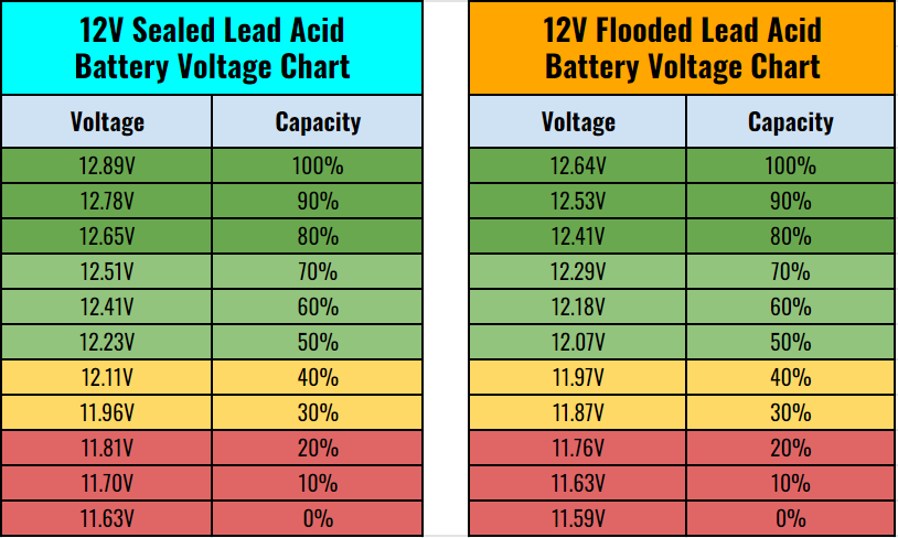

Charts on t’internet suggest 12.6v correlates to 80%, which looks about right.
I’ve had the solar panels switched off and not run the engine in an attempt to gauge the capacity remaining in the batteries. 13.0, 0Ah used when I isolated the MPPT at 19:30 on the 24th 12.6, 87Ah used when I turned on the MPPT at 15:30 today 26th I still reckon that we’re light users, 12v fridge or not!!
