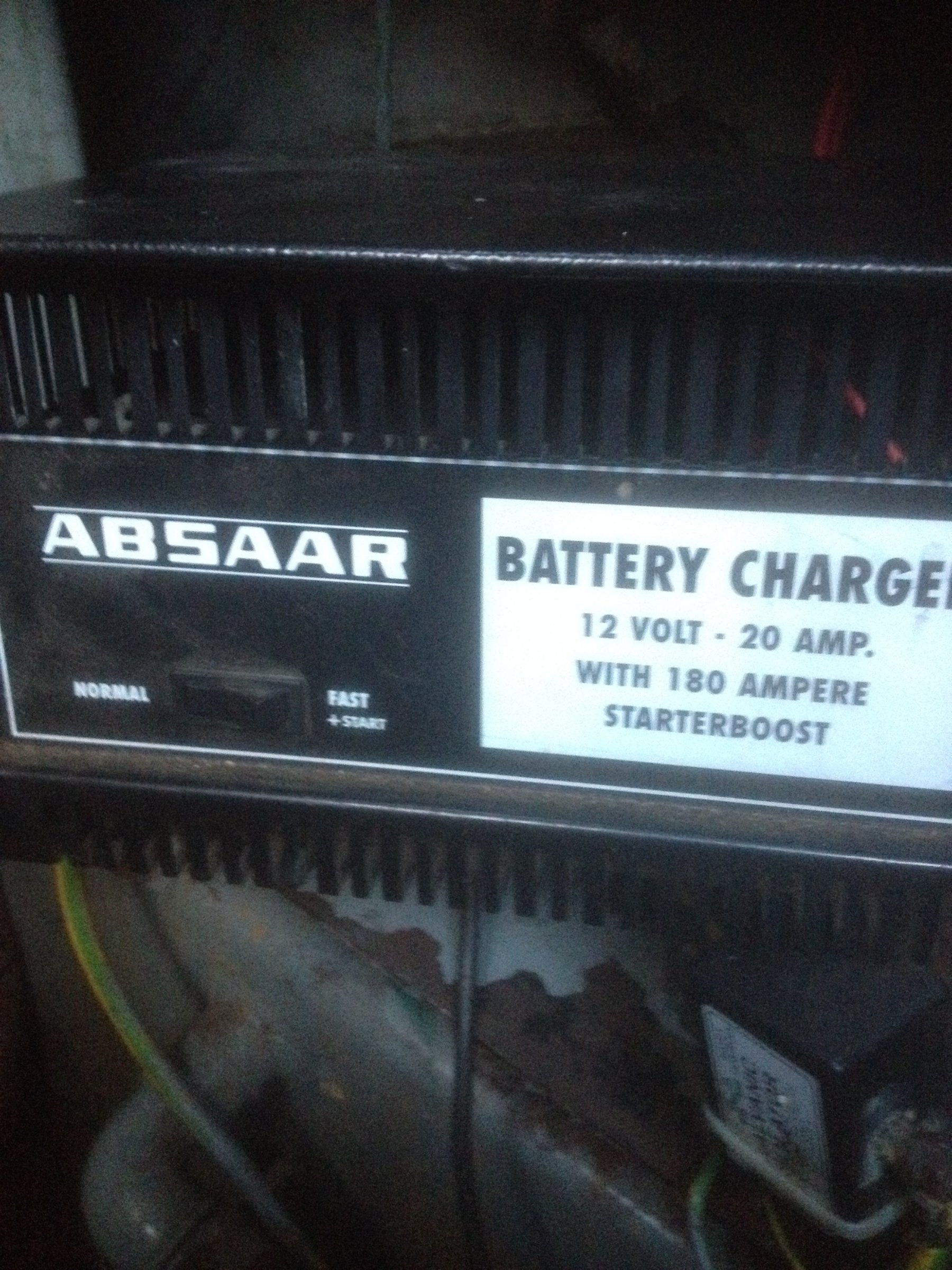

  1. I need a charger for permanently conectod when not on the nb
  2. Thanks lads looks like Ii will be looking for a new battery charger one that can charge 4 110 and that can be permanently

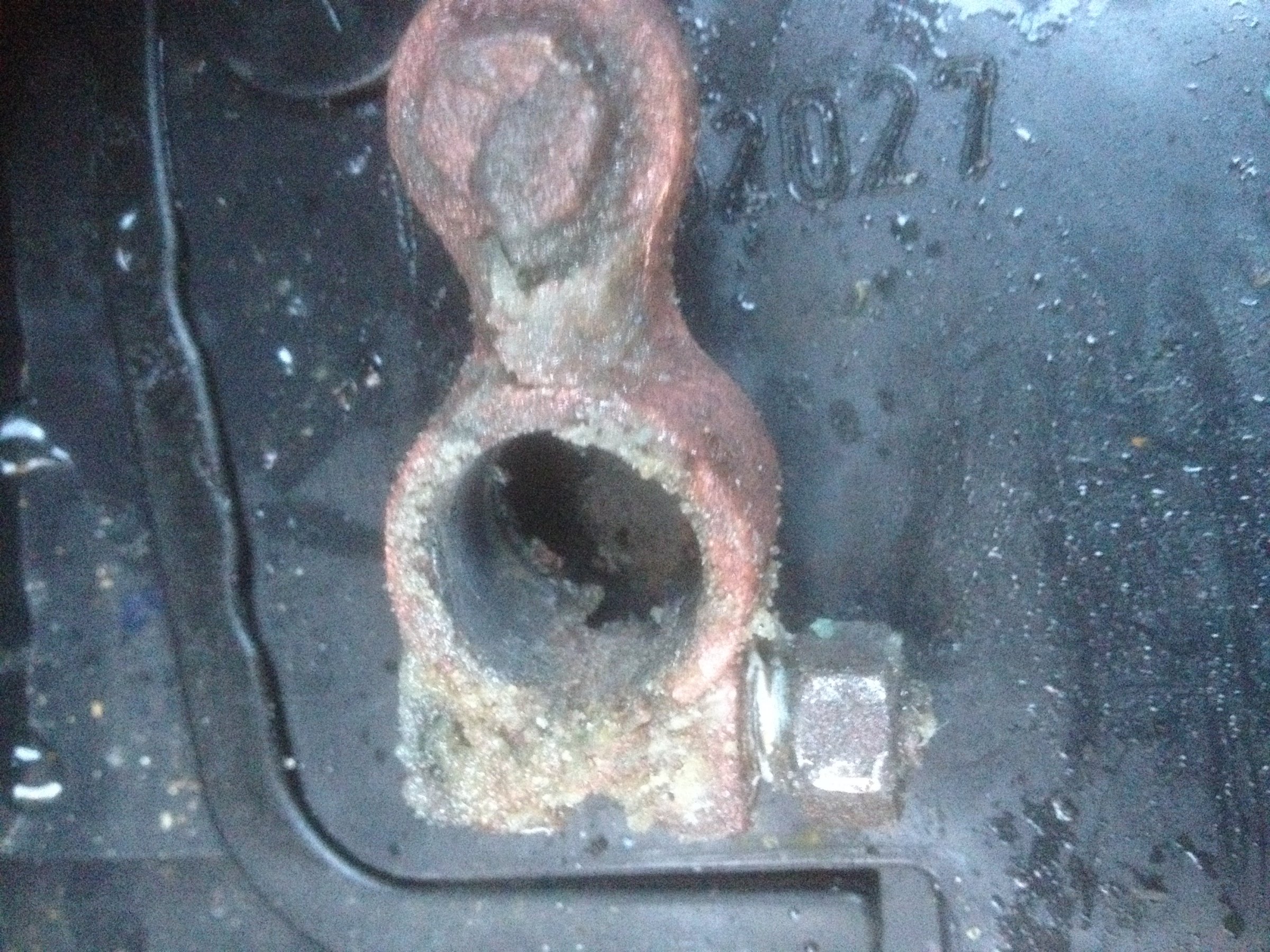

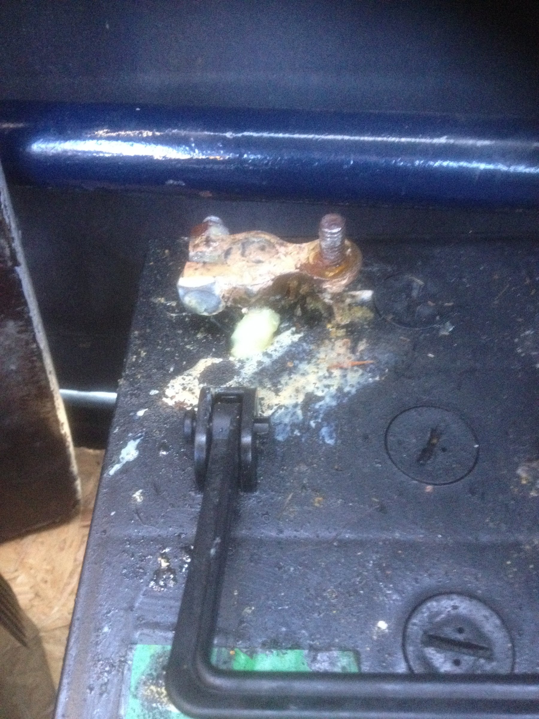

  3. Just been to the NB today. To check battery's as I had 2 on charge 1 is good the other on holding a charge ,put the other 2 on charge I will check the in the morning ,so the dud one must have been taking the other 3 down ,going to renew all terminals and put all new cables on hope this sorts my problems out
  4. i did have the engineer but he only looked a the cables running to the 12 volt fridge and he said they are fine ,going to get all new battery terminals check all battery cables and put Vaseline on the terminals dont think half the battery's were delivering power ,when trying to get at the battery's is awful and nearly 71 years old dose not make it easy. filled all with distilled water and put 2 batteries on charge ,might be no good now as some sells where bone dry
  5. Think I have found one reason why my voltage dropped at the 12 volt control panel oh dear some terminals nuts where loose and completely full of corrosion, and it took six pints of distilled water to top up four 110 battery's think the battery's were in some desperate nead of maintenances PS getting to my battery's is a right pain
