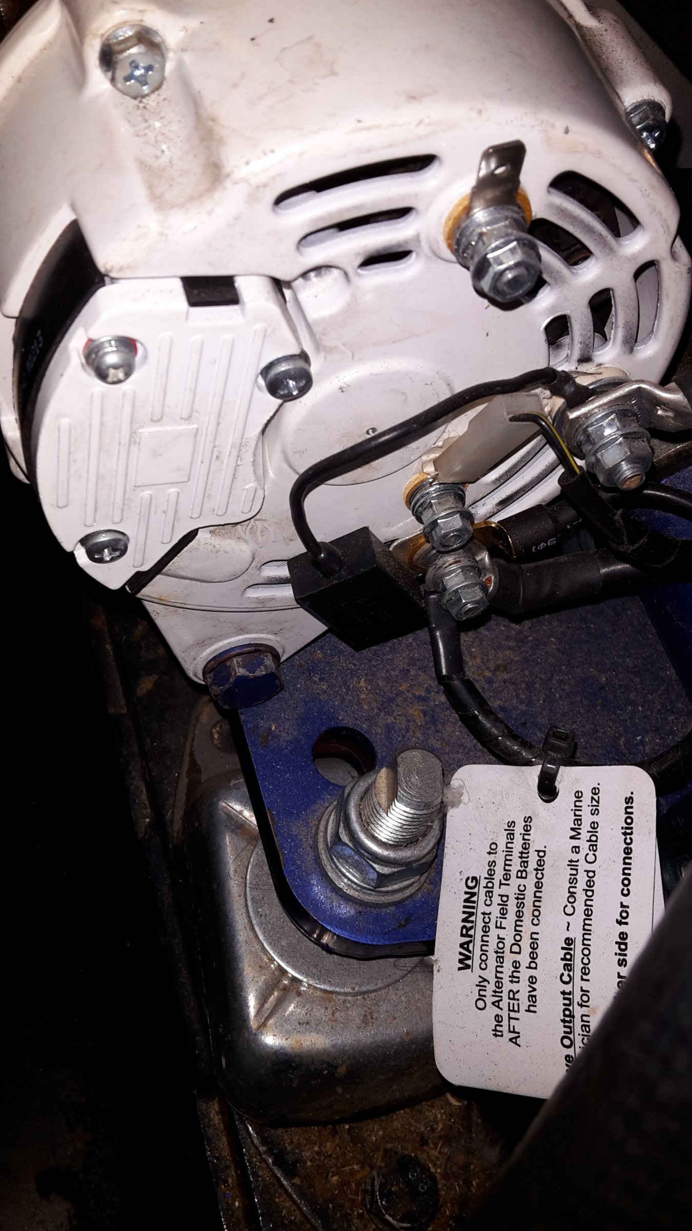

Thanks for the reply. I'm surprised that it's not a prestolite - the one I picuted is identical in every external way to the one on my boat. I'm near Skipton on the L&L so if you do know any local specialists, that would be great.
Thanks for the input all. A blown field diode sounds plausible. Bulding on Pearley's suggstion of fitting a new diode assembly sounds worth a try. Does anyone know where I can source them from? There are plenty of units on ebay (e.g. link), but plenty of results for Lucas a127 that don't look the same as my alternator (e.g. the picture below), so I'm concerned it won't fit (and trying not to dismantle the unit as it's getting a fair bit of use at this time of year). Thanks again. Ps Tony - I think it's only done 300 or 400 hours so I'm keen to keep it going. An exchange alternator is on my mind though. Edited to add (and tidy up), a bit more googling suggests it's the alternator below, which I haven't had much luck looking for parts for (ebay link). Prestolite 66021590M:
Hi all, The title is the short version - My auxillary alternator warning light is staying on despite the alternator pushing out it's usual current (I think - it's at least pretty much the same) and a quick investigation with a mulitmeter found 10.5v at the d+ stud. From my understanding of how warning lights work, one side is supplied with +12 (or more likely 13 - 14.7 when cruising) and before the alternator is excited the other is at 0v, causing the bulb to light. When running normally the d+ terminal would see roughly the same as the b+ terminal and so with no potential difference across it, the bulb goes out. In my case, I think the 2 or 3 volts across the bulb is keeping it on. This isn't such an immediate problem at this time of year as when sailing the alternator just pushes out max currenty all the time, but once the batteries get near to absorption charge (14.7v for me) there is minimal drop in current and the alterntor will just keep charging until the batteries reach a high voltage (it got to 15.5v ish before I noticed). Probably foolishly, I replaced the regulator (it was only £10 on ebay) but this has made no change. Does anyone have a suggestion for what to try next? Here's a pictuer of the alternator, though I can go back for more. It's the 90a auxillary fitted on a canlaine 38.
