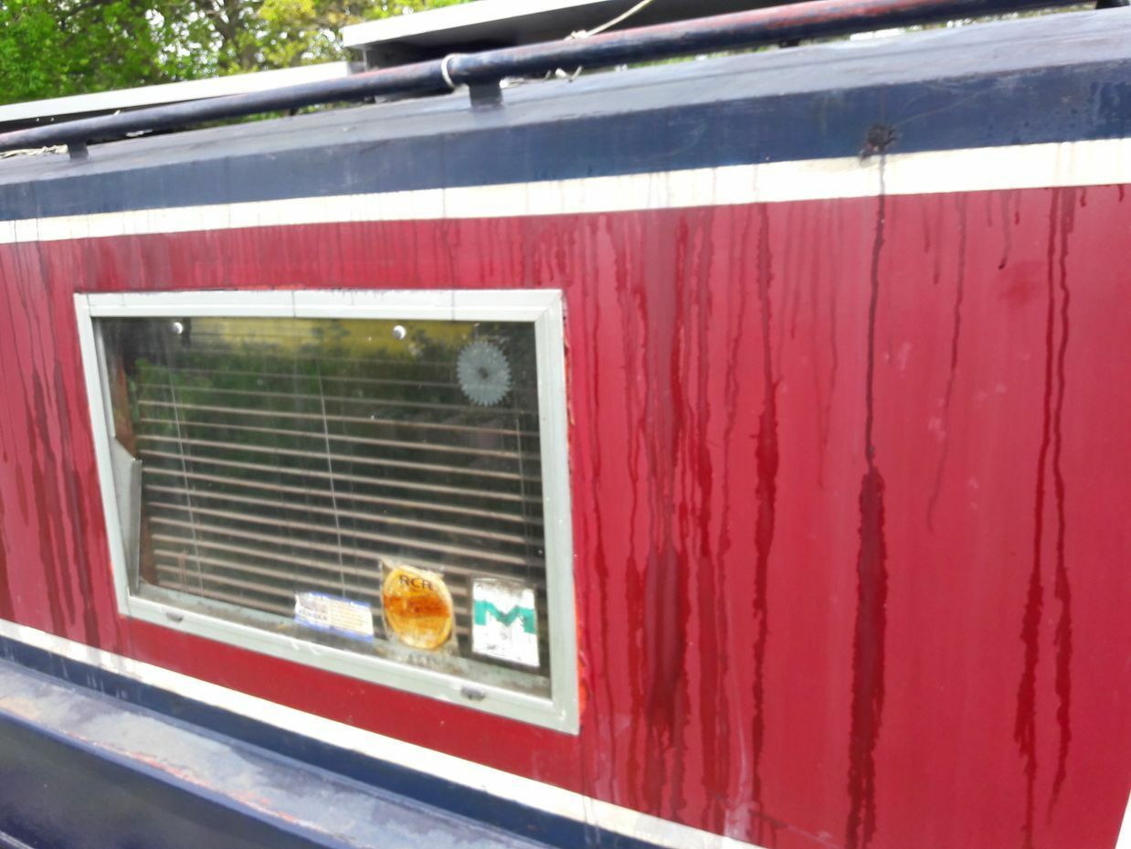

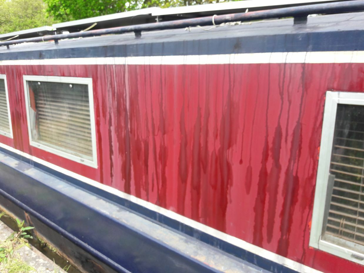

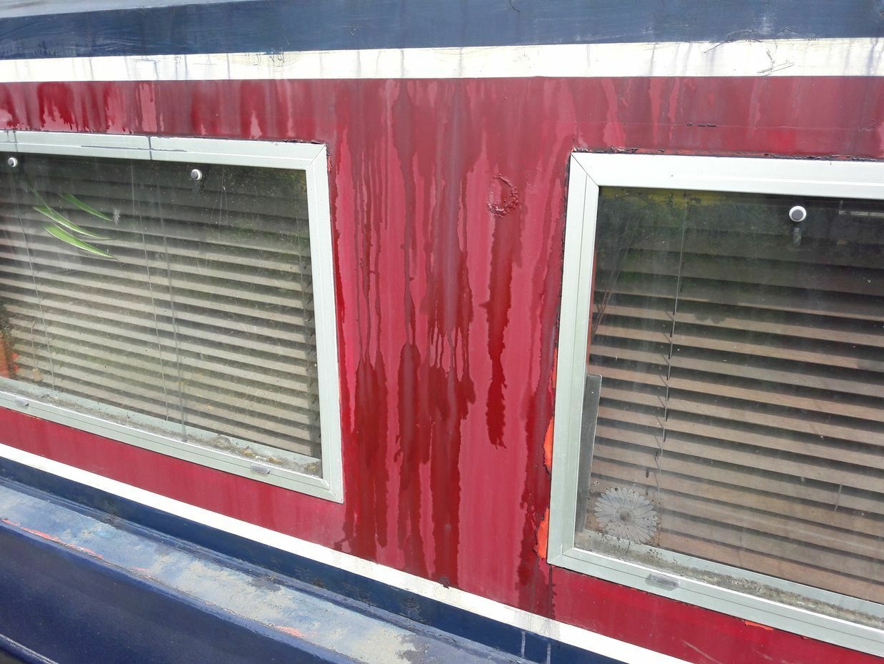

  16. Lol. Been using that bottle for YEARS! 😃😃😃 Had no idea Vactan has an eat-by date. Well, I've learned that the (very) hard way.
  17. Sunny (not hot) and not particularly breezy. It sounds like what you describe is probably what happened, though. Possibly.
  18. So, here's a question: how do I prevent this from happening again when I de-rust the rest of the boat? I'm not sure what I did wrong. Like I said, when I left it about 4 or 5pm yesterday, the Vactan was already dry and clear (no longer off-white colour), little of the rust had yet turned blue-black though, and there were no dribbles at all. By this morning: Title scene from a horror film. I can't leave the remaining rust untreated forever (as tempting as that may be) So what can I do differently next time? 🤔
