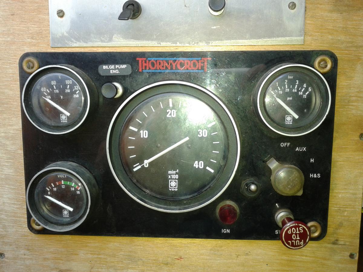

the mystery switch gets more mysterious the more I flick it. If I flick it whilst the engine is off then nothing happens no elecy is used (i have a power monitor) but when the engines running and i flick it the voltage on the display pictured drops by about 2 volts...though not on the power monitor....oh well I'll just ignore it until it becomes impossible to ignore.

above this panel is an on/off switch for tunnel light and a push button for the horn. the cabin bilge is conected tot he engine bilge so a seperate bilge pump is unlikely. (also the black pull switch at the top right is marked bilge pump, though the pump doesnt work!) I will test the mystery switch over the weekend. thanks for all the replies, at least i know its not going to indicate anything that can damage the engine if I put it in gear whilst its lit.
Hello all, This will probably sound like a ridicuously 'noobish' question but I've never had a boat with a decent instrument panel before so: what does the orange light mark IGN in the attached picture indicate? The engine (thornycroft 80D) starts up fine with this light (and an associated buzzer) remaining on for a few minutes. I thought it most likely to be oil pressure but now doubt it a bit. Thanks for any info! Also does anyone have any idea what the nearby switch might do? (the small silver one closest to the light) its not the bilge pump or tunnel light.
