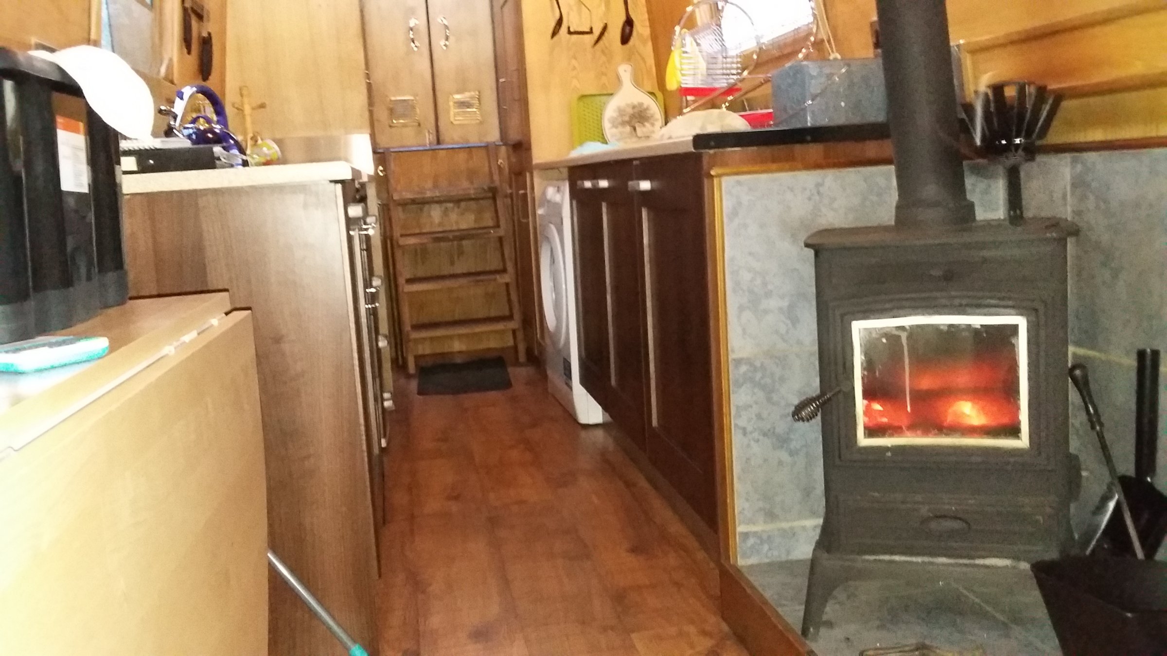

  1. Sorry can't remember the make but its a bog standard full size that you can get from Currys etc. Its in the galley right next to the sink unit you can see it in this photo
