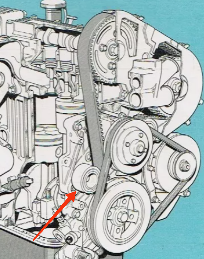

Ultraflex Control Cables
magnetman replied to Pot Noodle Adventurer's topic in Boat Building & Maintenance
2.25m length 2.54mm internal rod diameter. 2.75m length 3.65mm is how I would interpret the numbers. The longer and larger cable presumably being connected to the gearbox. -
I have not read the whole thread but find it slightly odd. "C8 M 2.25 254 and C8 M 2.75 365 cables that I'm looking for spares for. I've roughly measured the gearbox cable at 2.17m (not easy because of it's routing) so I'm also thinking that 2.25 and 2.75 are the cable lengths in metres." It appears to be rather obvious. -

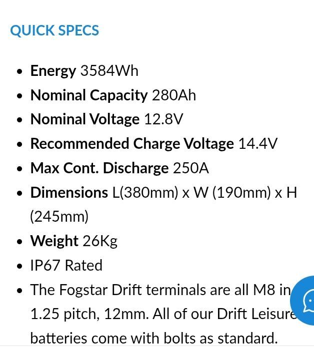

I think some people might believe that 'charge' is something you can do all the time without getting problems. If you put one of these batteries on a CV type charger which has an output of 14.4V it is going to hold the voltage at that level. This is known to cause damage due to the knees on LFP cell charge voltage curves and the way that the chemistry works.

I know what voltage is required but Fogstar say 'recommended charge voltage 14.4V'. This is too high but aligns with the figure average people probably have in their heads for alternator charging of lead acid batteries. So it is a marketing strategy. Sell people batteries which will 'directly replace' the existing lead acids. Sell more products. I suppose the number of people who take it literally and wreck the batteries is smaller than the number of extra units shifted from the warehouse so it is worthwhile. Also if you sell a battery with 300Ah of capacity it would be a bit naff to immediately tell people to only use 60 percent of the capacity as it then becomes a 180Ah battery.

Fogstar say at the point of sale that the recommended charge voltage is 14.4V so presumably they last for the warranty period when kept at this voltage. The average consumer is not going to be concerned with bulk and float they just want to charge and discharge batteries. I realise this is part of the marketing but if someone did leave one of these on a CV charge of 14.4V and it failed in a few years how would Fogstar be able to get out of the warranty claim? The recommendation is there at the POS and not everyone is going to RTFM .

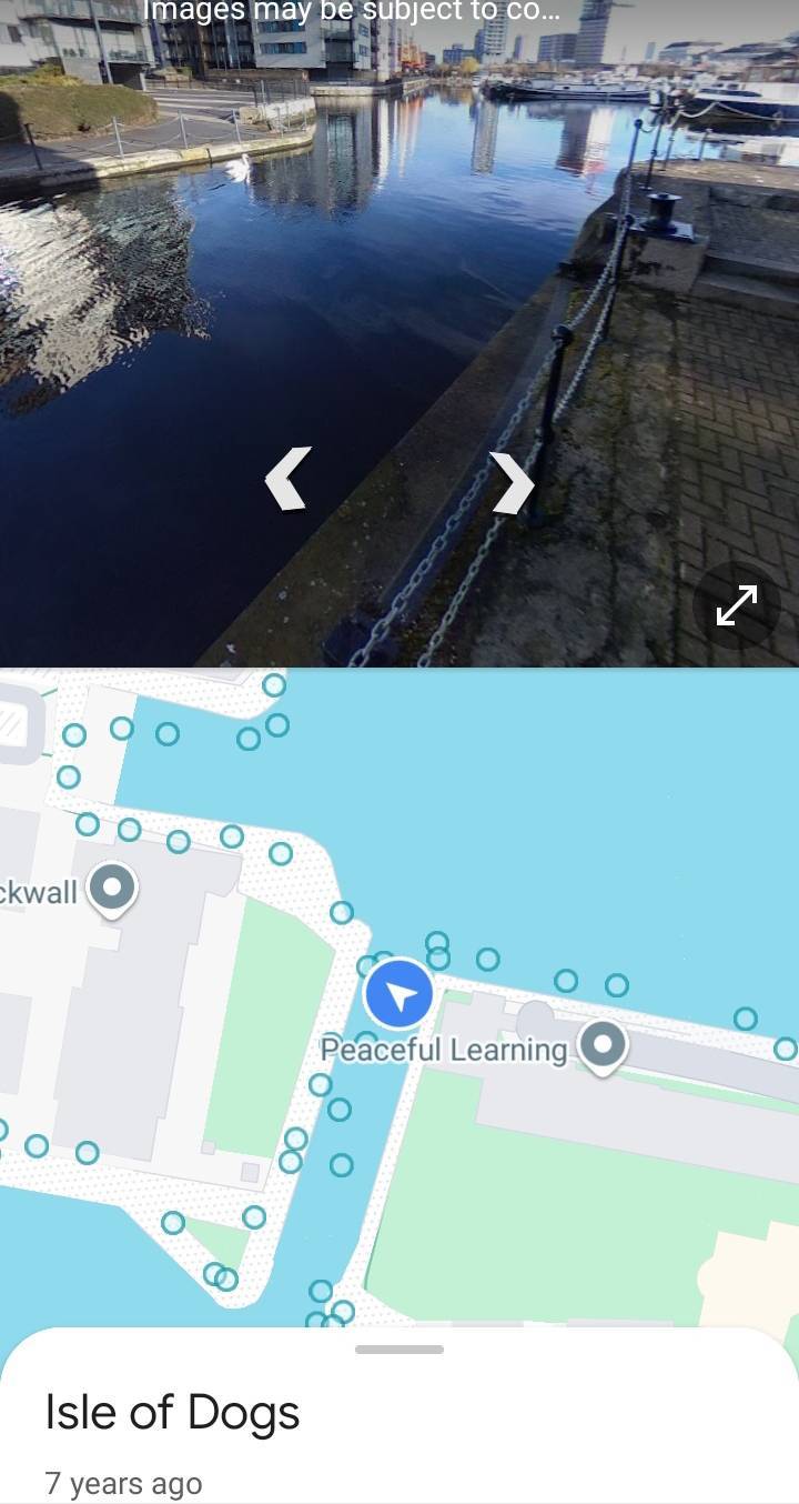

Not very practical if you miss the locking in window. I have twice arrived too late and used the outer pontoon. IT Was very rough once the tide started coming in again !!
Yes I think the ribs were using it I have seen it before and since the lock office and related CCTV system is now the marina office and nothing to do with the lock it is awkward to police that area. Thats probably why it has been removed. About ten years ago I recall someone putting a Boat there then left. The CRT called out a contract tug which towed it away as per the signage. Boats not to be left unattended. Actually that was more like 15 years ago and could have been BW. I think the reason for not leaving unattended vessels there is the ropes may break then it ends up floating about in a navigation channel with high speed vessel operations. Could be a PLA thing.
