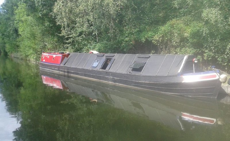

  9. Nice looking boat! Have you lengthened it, or is one of those internal pics part way through hull clean up and paint? Ian.

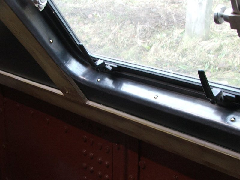

  12. No signs of any issues with water ingress yet Starman. The cable guides and cables are always hidden by the cloths either side. The 'U' tubes are offset (in that the inner leg of the U is longer than the outer on the bottom brackets) so even if water got into the tube it would not overflow inboard anyway, but like I say, there 'shouldn't' be water in that area anyway! The blind on the side hatches (the only ones I've done before the lining out) has about 5 loops on its sides which the cable goes through. This tends to make the cloth fold at those points. The window ones I am hoping will be easier to control as the cloth has more space above in which to disappear, so less folds will be required. In all honesty I like 'Heath Robinson' type gadgetry and look forward to the day I can open the lot from inside and reveal it's true use, rather like Jones' truck in Dads Army that had secret gun ports that could open in a hurry! Ian.

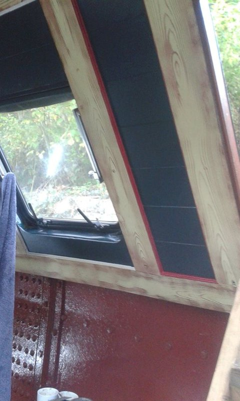

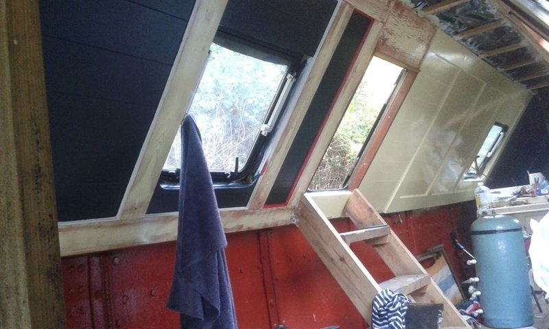

  13. Hi Starman, we are in the middle of our undercloth conversion. Our windows came from Channelglaze Ltd 0121 706 5777. Double glazed, openable and very little sticks out on the outside. Our boat has side cloths which helps disguise the top edge of the windows. They are invisible when closed and just visible at the bottom edge if they are just cracked open. The cloths initially rolled up to reveal the window, but this is a pain in the backside in reality and I always had a plan for making them openable from inside. This involved making four 'turnaround' cable brackets for each window. Cables run in a loop down each side of each window, half of each loop runs inside the boat. There is a crossbar between the two cables which is lifted to close the blind or pulled down to open them. I made up a sample on one of the doors before I did the lining out and insulation, just to make sure it was worth the bother! In practice it worked great so all the brackets were made up for the windows and doors. Folded steel brackets with a silver soldered 'U' bend tube which carried a throttle cable outer which in turn carries the cable. You can just see the inner ends of the tubes in a couple of pics. Now the insulation and lining out is done (all as per Koukouvagia' set up which has worked for him over several years and for which I'm very grateful!!) I am beginning to get round to connecting the blinds up. I'll get some better pics of the set up as I go. Hope this might help and isn't too late. Ian.
