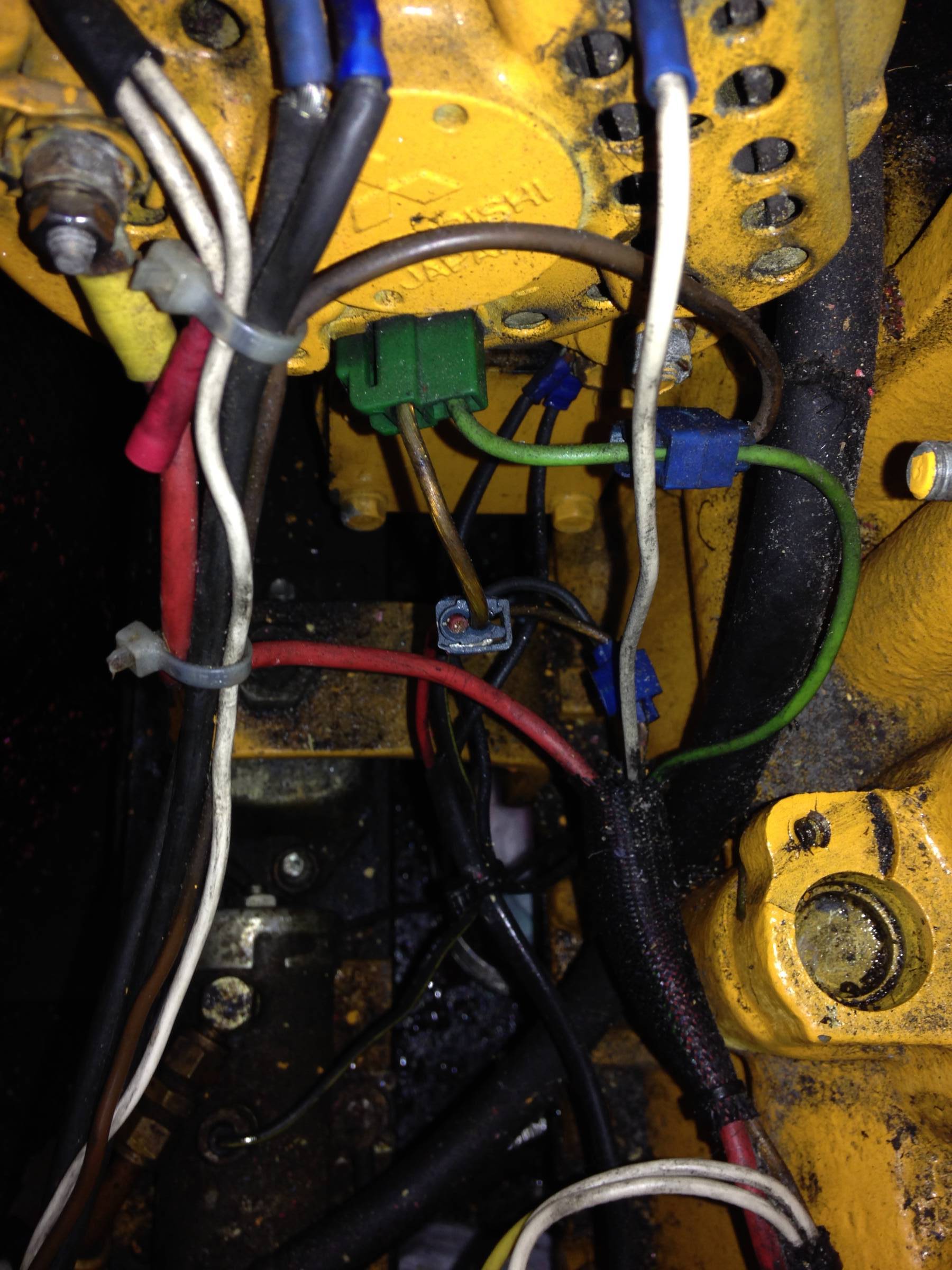

Brown wire, 2 possibilities. 1. the only extra fitted is a Sterling Alternator controller which the wire goes in that direction. 2. There is a brown wire scotch-locked into the the back of the alternator. I hasten to add, none of these "alterations" are my work, the boat came with them. As they work, I'm not going to disturb!! Bod

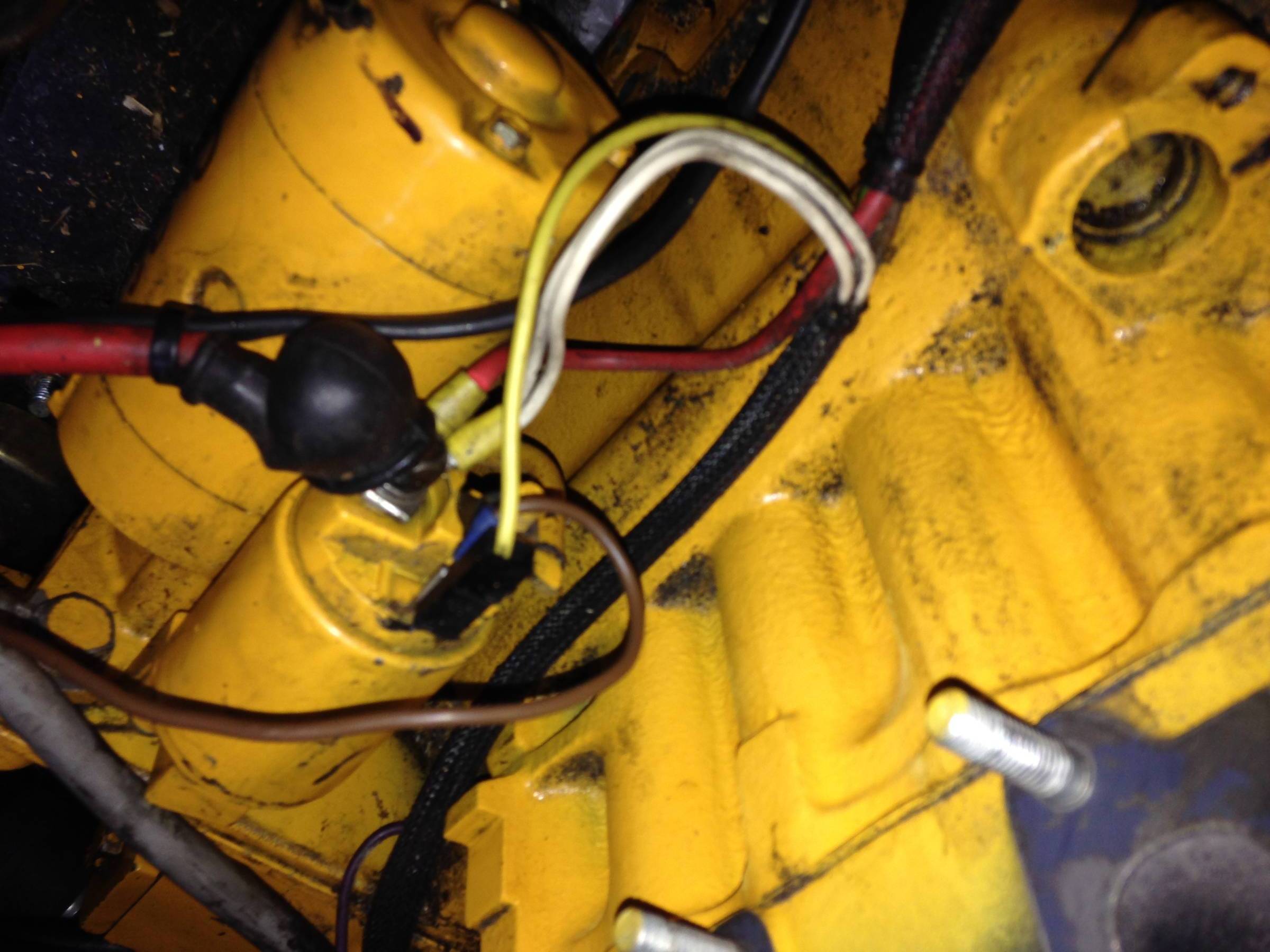

Apologies' for the upside down picture. This is the starter on my M414, which may be the same as the 310 (according to a Vetus parts list). Hope this helps. Bod
