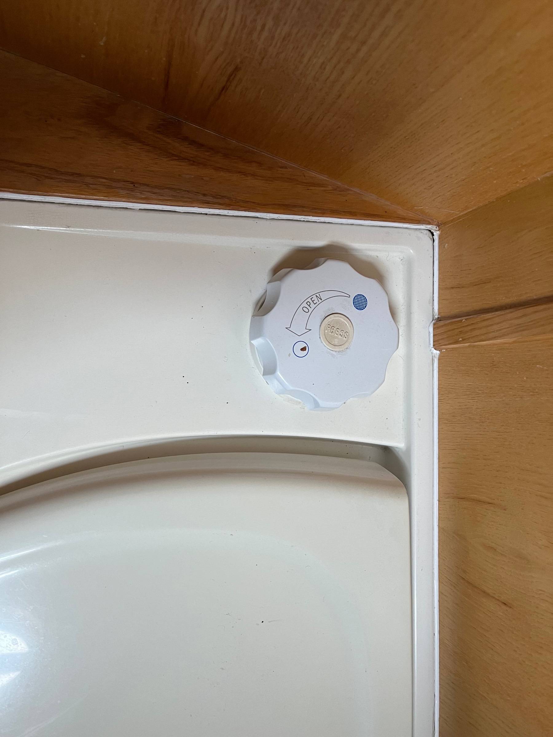

  5. New pump from eBay solved the problem. Easy job (but be careful not to lose the single tiny screw which holds the pump in place).
  6. My apologies to all who have offered advice and all those who have wasted their time reading this thread. The toilet is indeed electric. Fuse appears ok so it’s either the pump or the switch.
  7. Thanks for the replies. After searching more I now think I do have an electric flush. I had assumed it was manual because of the spring under the flush button making it feel as though I was pumping water and the fact that the electric pump made no noise. I am not on the boat at the moment but will search around for a fuse when I return in a few days.
  8. So you have actually fixed it before? I’ve only had the boat a year and it worked perfectly till now. I might as well have at least one go at fixing it before I give in.
  9. All the info I can find refers to toilets with an electric flush, mine is a manual flush. I have just refilled the flushing tank (with some of the pink stuff mixed in) but pumping the switch produces no flushing water. The toilet has been empty all winter so maybe the pump needs priming, or maybe something is broken. The spring under the pump is ok and pumping feels ok too but no water produced Photo of the pump/switch below. Can anyone point me in the right direction or I’m going to have to take a jug of water with me when I need to go?
