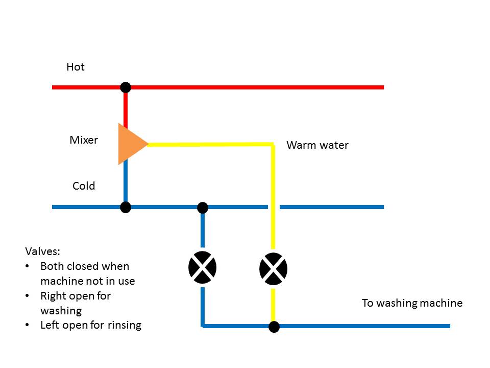

That looks suitably complex. Mark II design will involve a motorised valve controlled by the washing machine..
This is what I had in mind, with 2 valves to control whether the machine gets warm or cold water. I think that with your arrangement the mixer might get confused if there is no hot being supplied, and try to shut down the cold input. You could have the machine plumbed in permanently, though I guess it would be prudent to shut both valves when it is not in use to reduce the risk of leakage etc. There may be three way valves (left, right, off) that would be even neater (and simpler to use).
More interesting than you might think. The record of my recent trip is here
I installed a mixer valve ten years ago, and it has worked flawlessly ever since. I set it up so we have (very) hot water in the galley sink, and warm water for the bathroom sink and shower. It is adjustable, with an allen key, but I don't think you would want to do that too often. I guess you want a couple of valves controlling the supply to the machine, so that you have one open to fill from the warm supply (thermostat controlled) and then you close that and open the one from the cold supply for rinsing. I can draw you a diagram if you like! Or you could use a three way valve I am sure to do the job more straightforwardly .... Don't forget that these mixers have one-way valves in, so if like me you are paranoid about draining the system in the winter you need to have some way of draining the pipes downstream of the mixer. I installed a bypass with another valve in...
