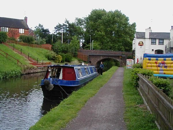

I work in Wombourne, right by the cut, and regularly have a lunchtime stroll from Giggetty Bridge 44 up to the Bratch. There’s a pub, the Round Oak by Houndel Bridge 45, which seems ideal for families of pre-teens. I’ve worked within 200 yards of the place for 5 years and never been in, but had mentioned to our kids that they’d got a playground and a bouncy castle, so they thought it would be a good idea to stop there.
Passing by work, just before knocking-off time, Lynn said “the light’s come on on the toilet, does it need emptying?” so we tied up, I checked, it did, I removed the cassette and water started spraying everywhere (that’s clean water for the flush). Turned off the water pump and closed the stoptap.
I’ve taken flexible hose from water tank to water pump, then out to copper pipe, teed off to ktchen sink, water heater, bathroom basin, toilet and bathtaps/shower, hot from water heater to kitchen sink, basin and bath - quite a few connections. Most plumbing is subsequently rendered virtually inaccessible, but I have fitted around it with confidence in my plumbing abilities. The feed to the loo comes from copper pipe to flexible hose, then connected to the toilet with one of those Hep2o push fit connections that many on this forum seem to enthuse about. As the connection to toilet has a flow restrictor in the connector, this is the only connection on the entire boat that I have not made myself, and the only one which has failed, so you can stick ‘em! :blink:
Fortunately, I’d left all my plumbing gear onboard, so I’ve cut that connector out, shoved the flow restrictor farther down the hose and used a hose connector and jubilee clips. Sorted. We then went on just under the bridge and moored outside the pub. Hardly saw the kids again ‘til bedtime, and they didn’t want to come in then.
So, for families with pre-teens (or early teens that don’t act it, like our Ben); Round Oak, bridge 45, recommended. Kid-free zones inside. Meals sensibly priced (£5-6), long-term promo; Curry Club: Sufficient but not massive, tasty not fiery, choice of curries served with papadum, small naan, rice or chips, mango chutney, plus a pint or glass of wine or J2O or fizzy drink all for £4.95.
