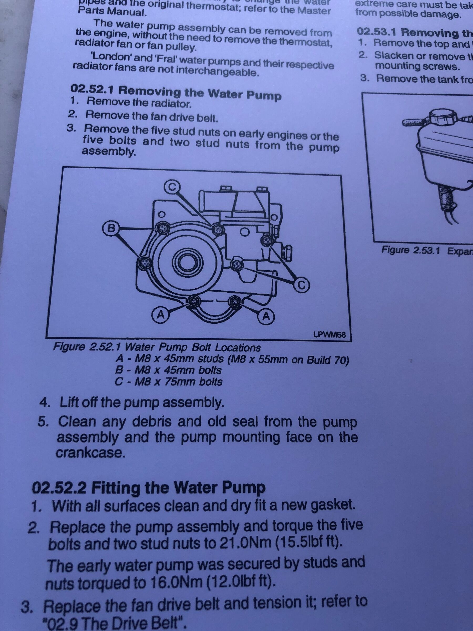

There is a (mounting/base) plate sandwiched between the pump and the block. I imagine the Lister manual is expecting this to come off to aid the refitting of the head. Is that correct? I need to have a closer look but I could not see how it is fastened.  I also need to check whether I have a gasket in the decoke pack for it.
29 minutes ago, SiFi said:
Thanks,
Yes. There are 5  M8 bolts and 2 stud nuts assuming it is a newer remgine: the old ones apparently had only 5 studs. Note where they come from different lengths. It pulls/taps IMG_0158.thumb.jpeg.8dbbeacf3406eddf5cf8c8b6162e844c.jpegIMG_0157.thumb.jpeg.ba2dd1a02c1dc046d32ed1261b5965ec.jpeg off forwards. The only thing holding it will be item 7 sleeve that I called stub pipe. What I was trying to explain is that item 7 will probably tremain corroded into the crankcase. I just left it in so you can only replace one of the o rings item 8
