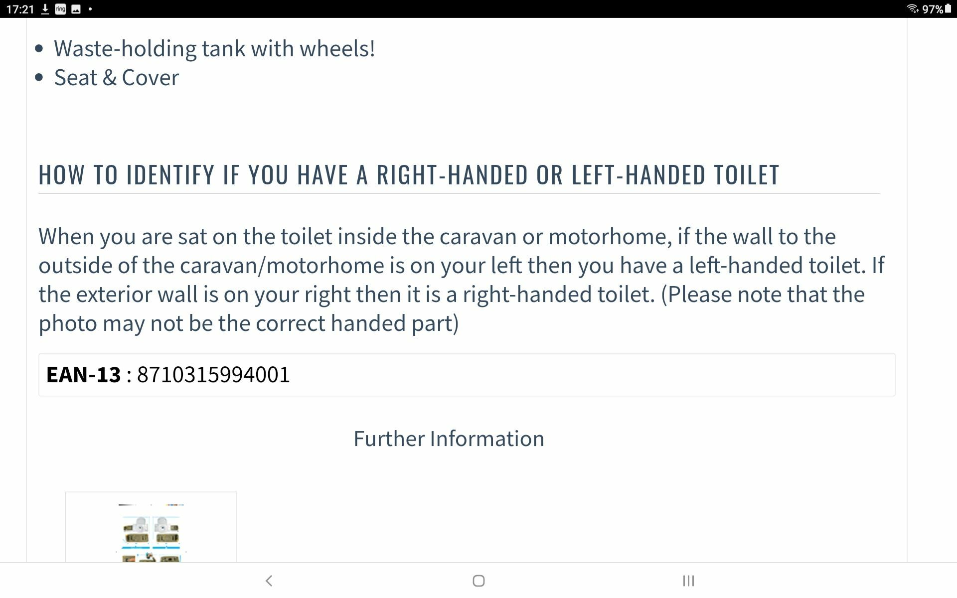

If its a refresh kit for a C2 it is a pretty dead cert. its a straight swap,  but as pointed out above with less holding capacity.
The main thing to watch with the C2 is that the replacement is correctly 'handed'. Though obviously yours wont open through an actual outside wall.
