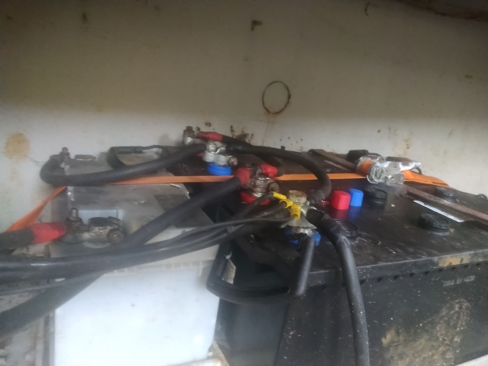

My two domestic batteries are 185 amp/hours each so I wonder what size of onboard charger would be best for battery life. I am expecting to find one that has the recommmended desulphating charging mode to try and keep the old cells going as long as possible. I started the motor to try and put some charge back in but as soon as I revved it up there was a new sound like a dry bearing so I stopped. The drive belts are both very worn and came loose after tensioning so I have ordered them up (and a spare set - it's the Boy Scout in me) Once they are installed I shall track down the bearing noise to an alternator or the water-pump. Meanwhile the Mikuni diesel pipe was fixed and it tried really hard to start but there is no fan noise so I have been recommended to have it sent off for a full check-over. In the course of my investigations I found a leaking elbow on one of the the Hep20 'circs' so have called it a day and gone in search of parts. -

Great advice as always. Thank you. The Snap-on battery testers are usually automotive. I think I have a better grasp after reading the battery primer topic. If I had stopped there it would have been fine but I fell soft and read the replies......... too much snow today to think about going to the boat. I'll try and get there tomorrow. Thanks again. Martin. -

Will do. Please bear in mind that after a brain injury I have no short-term memory for numbers or names or faces but so far as I know, at the start of play today they measured 11.8 volts. The tester showed that they held up under load which is why I said 'fine' The engine ran for about an hour (The alternator was outputting 14 plus volts) and they were up to 12.4 after only 5 minutes or so. I can't get back tomorrow but may do on Wednesday. I have no actual shorepower but do have a suitcase generator. I have a battery charger with 2 and 4 amp settings and so could set that up on the gennie, would that help? I'll put a cold towel over my head and read the battery charging primer again. Thanks. -

I'll have to get back in there after the snow has gone to see if I can read anything off the batteries. Looks like one of the labels is under the clamp strap which is how I missed it. -

Thank you Tracey, presumably the smallest Amp would be the gentlest/best for long-term battery-life? -

Hello all and thank you again. Zoe at Pennine Boats in Skipton kindly arranged for Jonathan to call in on his way past today instead of tomorrow, as snow is forecast. His Snap-On multi-tester was much better than mine, it even had a magnetic base! Jonathan did a load test and diagnosed that the batteries were low, but fine, and that the lack of charging was down to the cut-off switch being duff. Evidently they are very susceptible to damp, rust and a consequent lack of connectivity. One new switch later and the engine is charging nicely on both alternators (The loose blue wire being just as some suggested, a surplus thing) The 240 volt 'garage' trips needed a little cleaning of contacts and proper installation of the cover and that side of the boat worked under shoreline and also, once the batteries had charged up enough to get the inverter cracking, did the 12volt. I was feeling very happy until we tried the Mikuni heater which made some of the right noises but then manifested a big diesel leak which turned out to be a broken, previously soldered, rigid feed pipe, Jonathan had to leave and find some suitable 'flexi' hose to make up a more resilient connection so fingers crossed that works in the next couple of days. On the subject of battery charging, Jonathan's parting suggestion was that I look at installing a battery charger that would gently feed the batteries when on shore power so the engine didn't need to be run. He did not have time to suggest a particular brand or type and at the risk of making a nuisance of myself I wondered if that sounds like a good idea and bearing in mind that I intend to add solar panels at a later date, what would be the best solution to suit that particular scenario? The picture is of my battery bank and looking at the size of those traction batteries I'm very glad that they are ok. -

Thank you Tony and others, I guess that since the red cut-offs were both still 'on' that the leisure batteries may well be flattened and ruined. Nothing tripped on the 240v circuit, I just expected everything to work as the mains switch was set to that rather than 'inverter. The inverter is a pro-power Q 1800w. I shall carry-on my investigations to try and rule some things out/make remote diagnosis possible. Thanks again for your time. -

My boat was built around 2007. It has been sitting around without much use for the last ten years before I recently bought it. It has a shoreline galvanic transformer, Sterling 1800w sine-wave inverter with remote switch, Mikuni MX40 heater and two alternators on the Vetus M4.15/Technodrive TMC60 powerplant. There is a switchover control from shore to off to inverter and a 240v triple trip panel. From my searches on the forum I realise that some of those items may already be red-flags but please forgive my foolishness in not knowing that sooner. I selected 'shorepower' on the switch, plugged in my suitcase generator to the shoreline socket and flipped the 240 trips. The generator sensed load and speeded up but nothing on the boat worked, whatever the position of the individual 12v master switches. The boat 'ignition' key was not turned as I felt that it wouldn't logically need to be left outside in such a vulnerable position. Both red key masters (presumably one for each battery/bank) were 'on'. Deciding that discretion were the better part of foolish valour I switched everything off and started to check over the engine (which I knew was last started in December). Belts tightened and levels done I was delighted when it fired straight up and settled to a good, steady, smooth idle. There was a constant beeping but no lights showing on the 'dash' and a good 14v showing. Then I noticed the blue wire floating free from the larger alternator. Bugger! I realise that I should really wait until the boatyard electrician can find a spot for me but I should like very much to have a clue where to look first. I cannot see a connector that the blue wire has escaped-from and know that not all installations use all the alternator wires but.... As an aside, why is everything in the engine bay so hard to even see, let alone work-on, I feel that it could be mirror-lined to advantage and that even tough vertically challenged myself, Hobbits would make superior boat-techs.
