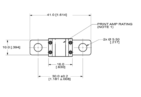

  9. Ok, that's cleared up some things...I was indeed misreading that quote. However, I'm still convinced something is wrong with either the fuse or fuse holder. I am perfectly aware of the issue with the OD, for the third time, thank you. I am trying to help here. I actually got out my electrical bits to have a look and do a little test to prove my point. Here's a photo of a Littelfuse holder and fuse, with an MTA branded 10mm2 M5 lug on one side and a 25mm2 lug on the other. Neither foul the plastic part at all. I'm confused as to how you've managed to install it in a fashion that does. Maybe I've misunderstood the issue? An M5 lug on a branded fuse holder with a branded fuse does not hit the insulation. Just the like the other 100 of these I've installed, this one does not. Perhaps you have a weird off-brand lug, where they've used the same lug for many different hole sizes so the flat bit is bigger? The reason hole sizes were of concern was that an M6 lug sometimes has bigger external dimensions than an M5, depending on the brand.
  10. I know what your issue is - the lug hitting the plastic insulation of the fuse. I also know that an M6 lug will hit the insulation, but an M5 lug will not. You said below that an M5 ID lug don't fit (the stud?), so I assumed you're using an M6 lug to fit the stud. However, as mentioned above, this will hit the plastic bit of the fuse.
  11. You said here that M5 ID lugs didn't fit though? Unless I misunderstood your post. That's why I assumed you're using M6 ones, which foul the plastic part of the fuse as you describe. I've fitted a lot of midi fuse holders and can say that I've never had an M5 lug not fit a Littelfuse, Durite MTA fuse holder with a standard Littelfuse fuse. I don't know what ones you're using.
  12. M5 should need an 8mm socket , but given the random assortment of metric and imperial nuts used on electrical things, it wouldn't surprise me if the studs were actually imperial...UNF 10-16, which has a diameter of about 4.8mm, and the nuts are something like 9.5mm across the flats, which would mean a 10mm socket kind of fits! I do understand the issue - see below. It sounds like you're using an M6 lug with a fuse designed for an M5 stud, so the OD is an issue. If the M5 lugs don't fit, then you may have a weird fuse holder with M6 studs, in which case the fuses will be a very tight fit but they'll sort of squish onto it. Can you post a link to your fuse holder and fuse? A photo of yours would help too. This is the issue. You need an M5 lug to work with your fuse. Sounds like the fuse holder is the problem. Putting washes between the lug and fuse (or anything for that matter) is generally bad practice; with midi-fuse level of currents you'll get away with it, but you'd be surprised at the voltage drop over a washer due to the extra contact surface. Best to have the lug contacting the thing directly.
  13. Midi fuses have 5.5mm holes in them, here's the specs of a Littelfuse branded one. Fuse holders therefore usually have an M5 stud, which has a nominal 5mm diameter. Here's some examples that mention M5: https://www.12voltplanet.co.uk/midi-strip-link-fuse-holder-stackable.html https://www.12voltplanet.co.uk/midi-strip-link-fuse-holder.html https://cms-pim.durite.co.uk/durite-shop/quality-core-components/wiring-accessories/fuses-fuse-holders-and-circuit/fuse-holders/midi-fuse-holder-side-stackabl/037885-fuseholder-for-midi-typ.html Lugs with an M5/5mm hole are easily available from the usual outlets, here's one on the 12v Planet site: https://www.12voltplanet.co.uk/copper-tube-terminal-6mm-max-cable.html edit: If the studs were M6, the fuse wouldn't fit. However, there is a chance that you somehow have a weird off-brand Amazon etc fuse holder with M6 studs which came with non-standard fuses with a 6mm hole in them, there is some odd stuff floating around!
  14. Most midi fuse holders have terminals to fit M5 lugs, are you sure your lugs are 5mm? M6 lugs will hit the fuse as you describe. Check the product page for your fuse holder or measure the stud diameter.
