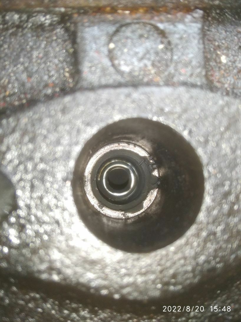

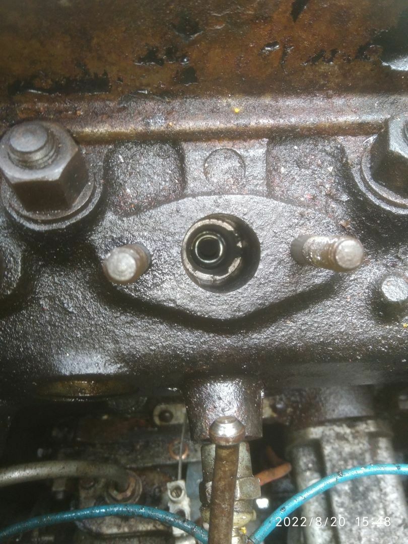

  16. I felt I did the best I could without knowing the Top Hats were removable. I have now read that they can stick to the injector and come out as one lump. Mine didn't move. It is possible this was a bodge by someone who had the copper washers but not the top hat, or they couldn't remove the top hat. I tested the new injectors for opening pressure and pattern. I felt the spray pattern was lopsided towards the side Aux hole and was a good mist. I didn't check for back leakage and TBH assumed that would be the least of my concerns especially with new nozzles.

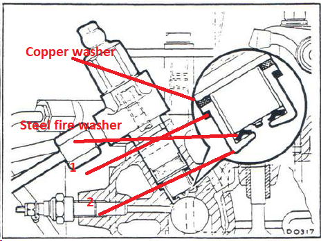

  17. I changed the Steel fire washer and the top copper washer. Yes, the fire washer was at the bottom of the bore, this would have been changed, or was the changed item. I assume you mean Thin Washer [1] Top Hat [2]? I wasn't aware that the 'top hat' was removable, and it seems it is this item that has become eroded. For future reference, are they easy to change? The ones advertise on ASAP Spares are a copper colour. The ones at the bottom of my injector bores are very steel coloured.
  18. Yes, I got a modest supply of heat shield washers from Bob Becks and wouldn't reuse them.

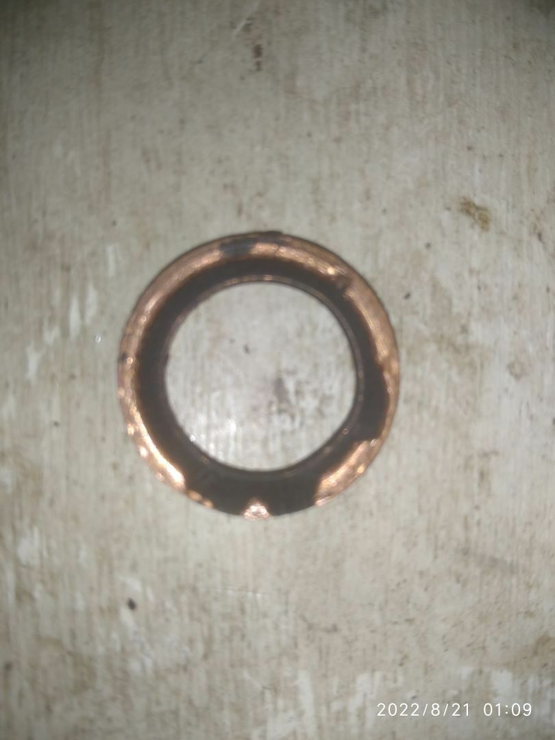

  19. My engine has always smoked and would miss on tickover, firing on 3 then back on 4, so took the plunge of sorting out some spare injectors. In the end I got 4 new nozzles and use my pop tested to set the opening pressure. I got new heat shields and new copper washers hoping this would be a simple job. After removing the old injectors I was aware that not all the old copper washers were the same, two were stuck in the injector bore and a bigger diameter than the others. I was also aware that No 2 injector bore looked as if suffered erosion. After fitting the refurbed injector with a new washer, it was obvious when cranking the engine that this washer wasn't sealing. After running for just a minute or so this is what this washer looked like: Given the old injector didn't leak the clue was in the old washers. The standard washers are OD: 21.0mm / ID: 14.5mm / Thickness 1.5mm The old larger diameter washers were OD: 21.6mm / ID:17.0mm / Thickness 0.85mm To compare with the bore, this is ~21.5mm, the injector body mid diameter being 21.3mm So, I heated the old 21.6mm OD washers to red heat and quenched them in water to anneal them. I fitted these into the No 2 Injector bore and after refitting and starting the engine there were no leaks. I can only assume that when tightened down the washer expanded sufficiently sideways to seal against the bore if not just the 'shelf'. It was a relief that I didn't have to swap heads. I did come across this size washer on a US website namely: https://www.superiorwasher.com/washer/815-422-040/815-422-040.html but I can't find any UK suppliers. I found a seller on eBay selling a washer with the same OD 21.6mm but with a ID of 8mm. I'm sure the centre ID could be enlarged. I'm pleased to say there is less smoke, and there is no misfire. I had a look at the old injectors. 2 were marginal in that the opened at a slightly lower pressure and spray pattern was distorted. The other two were worse, one would open at half the pressure to get a dribble out of of the idle spray hole. There being no 'snap/pop' action I might expect from a half decent injector. The injector nozzles worked out at a little over £50, and the tester another £60. Apart from setting opening pressures the tester gives you some confidence an injector is in working order before fitting. I thought I would pass on my experience. Also don't allow any exhaust to leak by the injector for any length of time!
