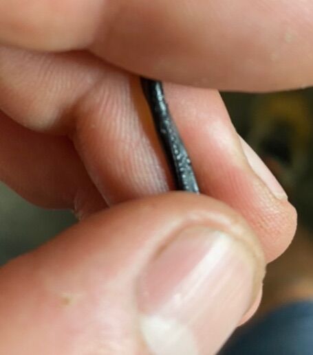

Ok here we go! So a friends 1.8 BMC had a run away incident due to pump seal failure and subsequent diesel in the oil. A common story, however….we replaced with a re furb pump and got it up and running before it would just die again. So, checked for air and no air. Changed filters etc and came back to the lift pump which was also replaced. Now this is the interesting bit. It seems like the lift pump is not pushing through fuel. As if the lever is not being activated by the cam lobe on the cam shaft. It has been healed in correctly so I know this is not the issue: when I placed my finger on the lobe on the camshaft and felt about I could feel a piece of metal spinning freely on the cam lobe. We turned over the engine and found that there was little movement on the lobe. I then held the pump in place with my hand and got the engine turned over. No resistance or pressure pushing the pump towards my hand. my hypothesis is that during runaway the Cam lobe on the camshaft has somehow failed and has become in effective? Thoughts? My friend is now considering blanking off fuel pump and fitting a in line electric pump. anyone fine this and any recommendations? Thanks for your help as always. Simon

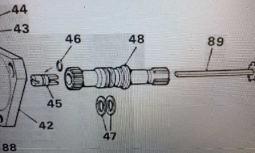

I feel I’ve gone full circle all the way back to the pump. I had a good discussion with a local diesel pump refurbisher who when overhauling the bmc pumps replaces the bushing in which the main drive shaft sits. He has such good knowledge of the pumps. We looked at the newly refurbished pump from Calcutt and agreed that the o ring had gone on the guide dog causing diesel to leak through the centre of the shaft. I thought I would have a look at what had happened out of curiosity to the refurbed pump, I had assumed that the o ring would have been replaced. Well I was wrong. Obviously got missed. Found a brittle perished o ring that I’ve now replaced. Probably missed on the overhaul. Chuffed that I found it. so I’m back to another pump being fitted and hoping that the case can now be closed. Now where have I said that before…..😳😂

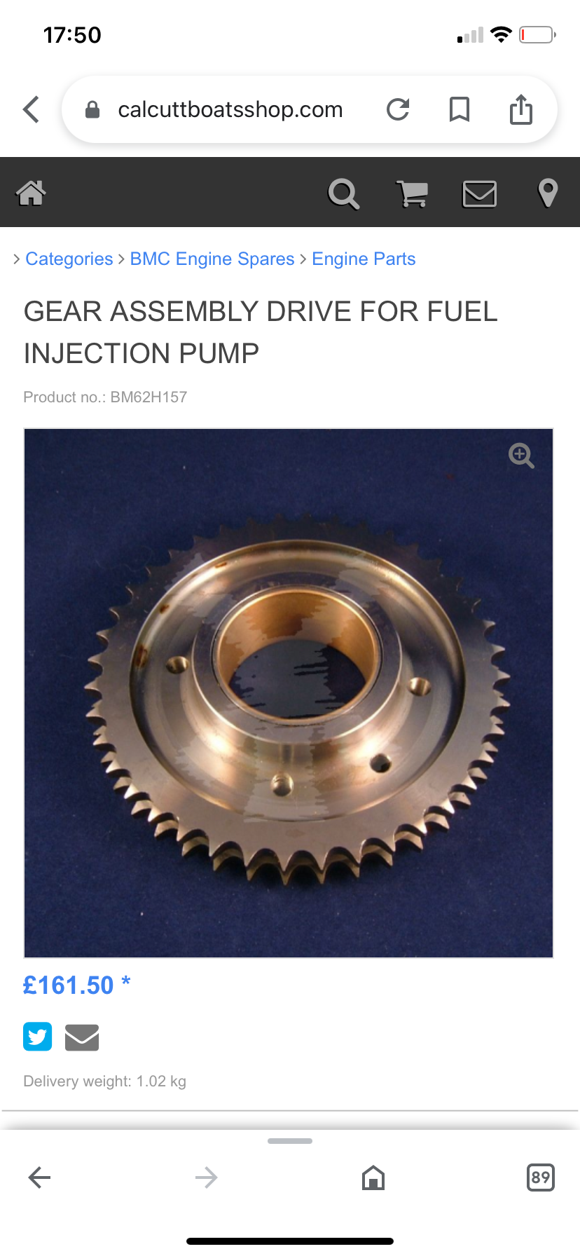

Thanks Tracy i think I’ll definitely need both the part that the pump mounts on to as well as the diesel timing cog. I’m guessing both parts will where out together? I’ll service behind there as well. Looks like I’ll be missing the enjoyment of boating for a while 😢

I was thinking that if the guide dog, part 45 was turning then the fuel could be leaking at this point any actually the seals?

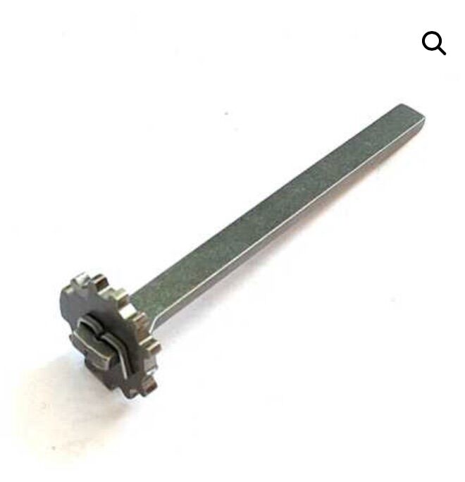

So…….I know I’ve been on this for sometime but I think this could be the issue? when I removed the pump initially there was no torsion bar key. Thus I didn’t assume to refit one. Could this be the reason why I’m getting fuel in the sump? Exceed play in the shaft? Tony, thoughts.
