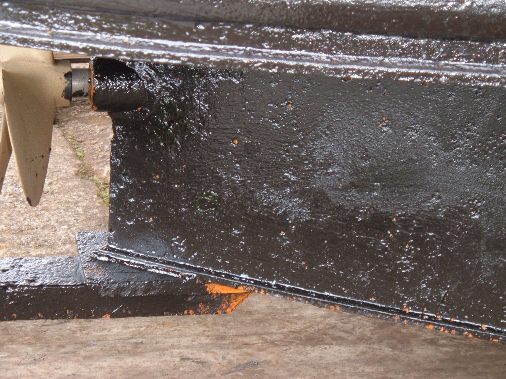

  4. Re the crap steel theory. 1) The boat was built by Dragon Narrowboats of Oswestry. Although I would class it at the budget end of the market there are hundreds out there with no issues, and they build narrowboat hulls as part of their main business - Premier Motor Bodies, building skips and refuse vehicle bodies. To me, that would negate the crap steel theory alone. 2) Also study the images I took again. The surveyor who was the specialist in this type of corrosion suggested that the side moored against the steel canal banking would be affected the most in the event of this type of corrosion taking hold. I always moored facing up the Llangollen Canal, starboard side against steel piling. The images show the most severe pitting on this side, with the holes that sunk her also on this side. The image of the port (canal side) - the one that includes the image of the anode, is nowhere near as badly pitted. This was the same right along the rest of the boat too. So if the crap steel theory is to hold up, then the port side must have been built with better steel than the starboard side? 3) When we acquired the boat in March 2009, having been first used in September 2004, there were no visible issues at all with the hull - 4 trouble free years from new. The previous owner had blacked her in 2005 and again in July 2008 - I have the receipts. When we took her over on the same mooring, she was severely damaged by hull corrosion within 5 years, even though we had (supposedly) kept up with regular blacking in less than two year intervals, three further times. The only difference in use between us and the previous owner is that we kept her connected to shore power permanently to keep her batteries charged between visits, and he did his own blacking. The bottom line for me after the event is that I placed too much trust in those I paid to do the hull inspections and blacking. Had I seen it myself, I would have ordered much earlier investigations as to why the hull was pitting so badly between blacking and also ensured a good blacking job took place, because in my opinion the last blacking job was nowhere near a good job, with bare metal left everywhere apart from just painting over an obviously severely pitted hull that they had painted every time since September 2009.

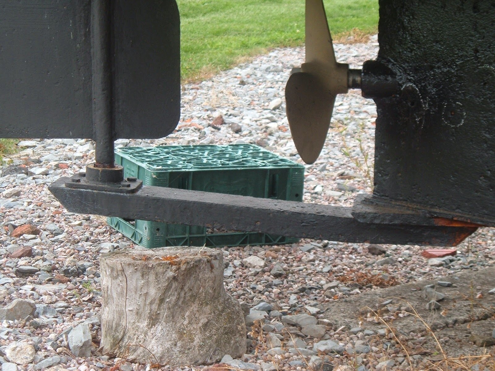

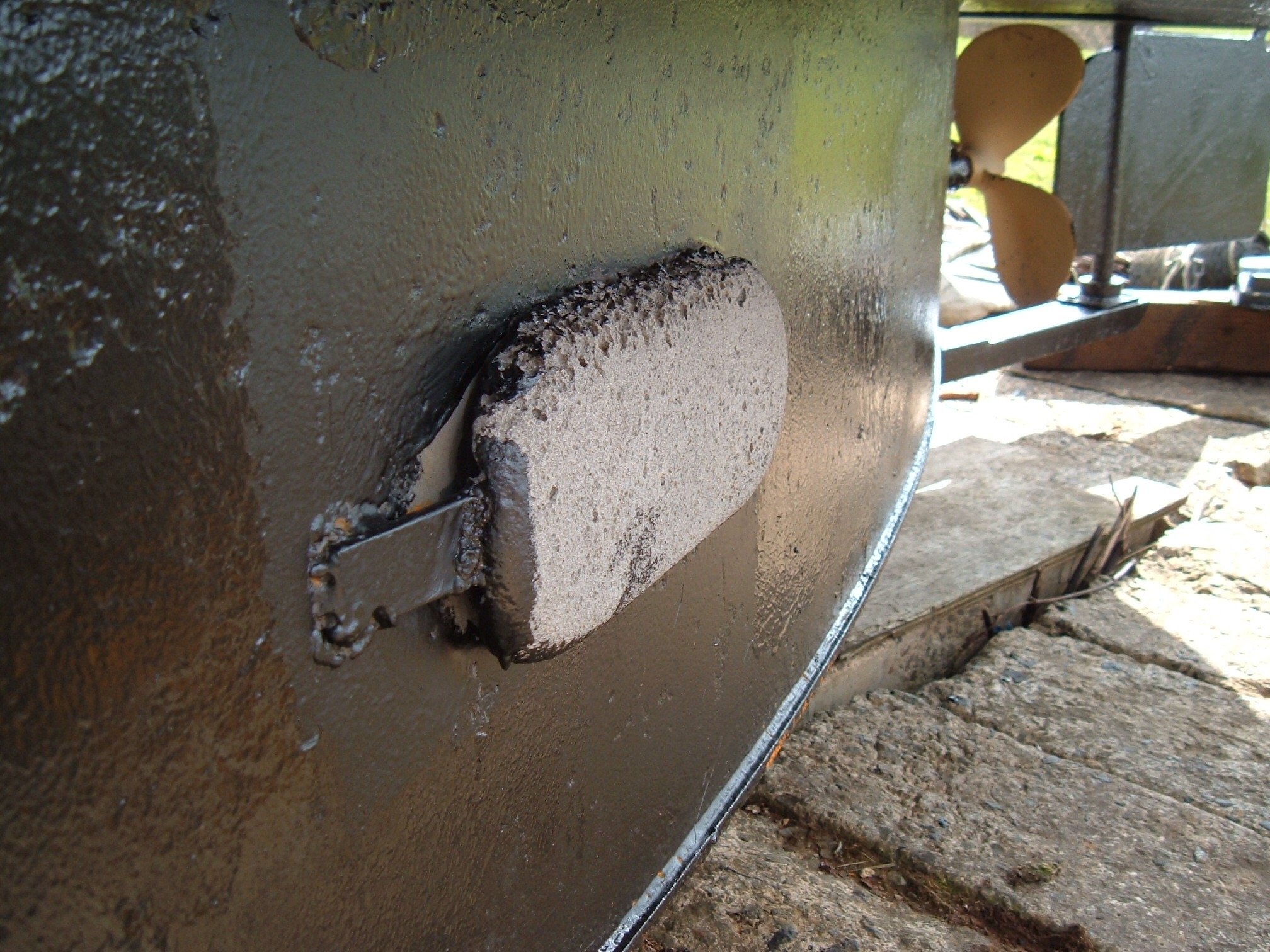

  6. Something that always stuck in the back of my mind after the event. Look at the images of the prop. It is in perfect condition and is the original 2004 fitment. After my own research on this subject I would have thought the prop would have been eaten away by corrosion, but it was the steel hull that was. Although the anodes were discovered to be more worn that I would have preferred when I first saw the underwater hull ashore, and should have been replaced as I asked before this work, they too are original and not that worn compared to the steel hull.
