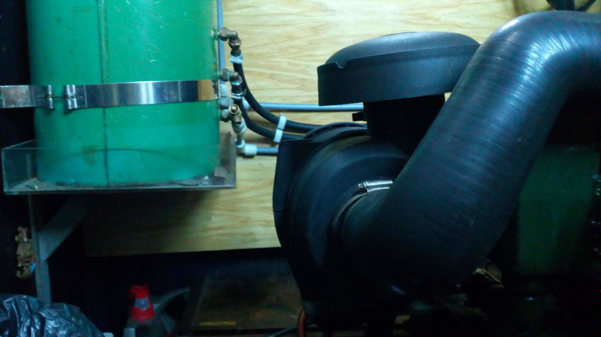

Beta JD3 calorifier confusion
barmyfluid replied to barmyfluid's topic in Boat Building & Maintenance

As requested: The top of the header tank (outside) is about level with the bottom of the 'mushroom', and the calorifier in/outs are the 2 pipes above the metal band, if I filled the tank almost to the top then they'd still be 2-6" higher than the water level. Will try filling the header some more, can't try and bleed the cylinder head right now as don't have a square socket of the right size to fit the plug (15mm/5/8th?). It's crane in day tomorrow (touch wood, was supposed to go in last week) and I'll be able to give it a proper workout, see if I can get confirmation the keel tank is circulating. -

I'm not on the boat till tomorrow for a photo and double check, but the calorifier inputs on the tank (vertical, dunno what the internals look like) are about level with the top of the engine, maybe a little higher. However, the coolant level in the header is about half full (btw, what level do you full you're to? Says nothing in the beta manual), so definitely a good few inches lower, and that's the confusion - surely they'd just drain out like you say! But they're the only bit that I can actually verify are working, both getting hot, domestic water warming ok.... Everything else is pretty much cold after the hours run i mentioned in the op, header tank, copper pipes off it., Oil cooler.. One of the keel tank inputs ever so slightly warm. Btw, have you still got the beta header tank mounted on the gearbox end? -

Brilliant Dave, thanks a lot - yes, it's a Colecraft, built 2005, there is a calorifier feed coming straight out of the side of the block and back in over where I guessed the water pump is at the right hand side near the exhaust stack. Will check the bleed point tomorrow, there's a cover over all of it at the mo. The calorifier tank is bolted to the wall, and the in/outs are higher than the level in the header tank - I don't even know what the level is supposed to be in there, it's about 1/2 full right now, but if I filled it right up the connectors on the calorifier would still be higher by a good few inch. Could there ever be a situation in which there's fluid in the calorifier circuit, fluid in the header tank but an empty skin tank circuit? It was sat on brokerage for quite a bit and probably never reached thermostat opening temperature for a long time - there was also a fair bit of water in the engine room bilge with ingress as yet unknown.... -

Thanks for the replies, though I still don't understand the calorifier connections being higher than the header tank and not draining back down, unless the main cooling circuit locks this off via the thermostat and the water pump initially primes it once the thermostat opens - where does the air go though? There's nothing in the Beta manual about how it works (or draining/refilling/priming everything), and the John Deere 3029 manual I've found doesn't show calorifier connections - guessing this is a Beta modification. BTW, it's got a keel tank under the engine, can't see any bleed screws on it but imagining it wouldn't need them in the same way a vertical skin tank would. -
